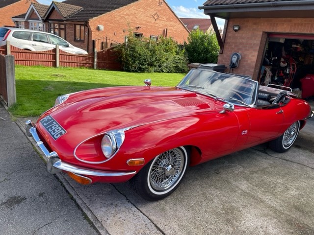

Well I think I have caught the bug. My S2 OTS is shiny but obviously has been quickly sprayed to sell so what lies beneath? It is heavily undersealed, again obviously done recently but a poke around with a screwdriver has not revealed any horrors so far although there is obviously some filler above the rear bumper.
I am wondering now whether to get underneath and in the wheel arches at the back and scrape off all of the underseal to get a better look at the body condition? I have lifted the carpets and the floors look fine but you never know... I suspect this will quickly turn it much more of a strip down than i had anticipated as I would like get this looking and working much better!
