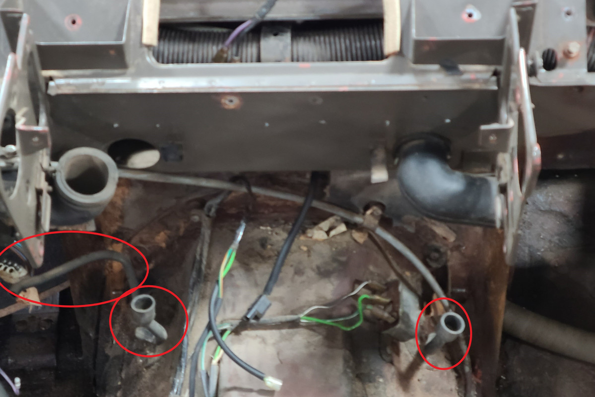

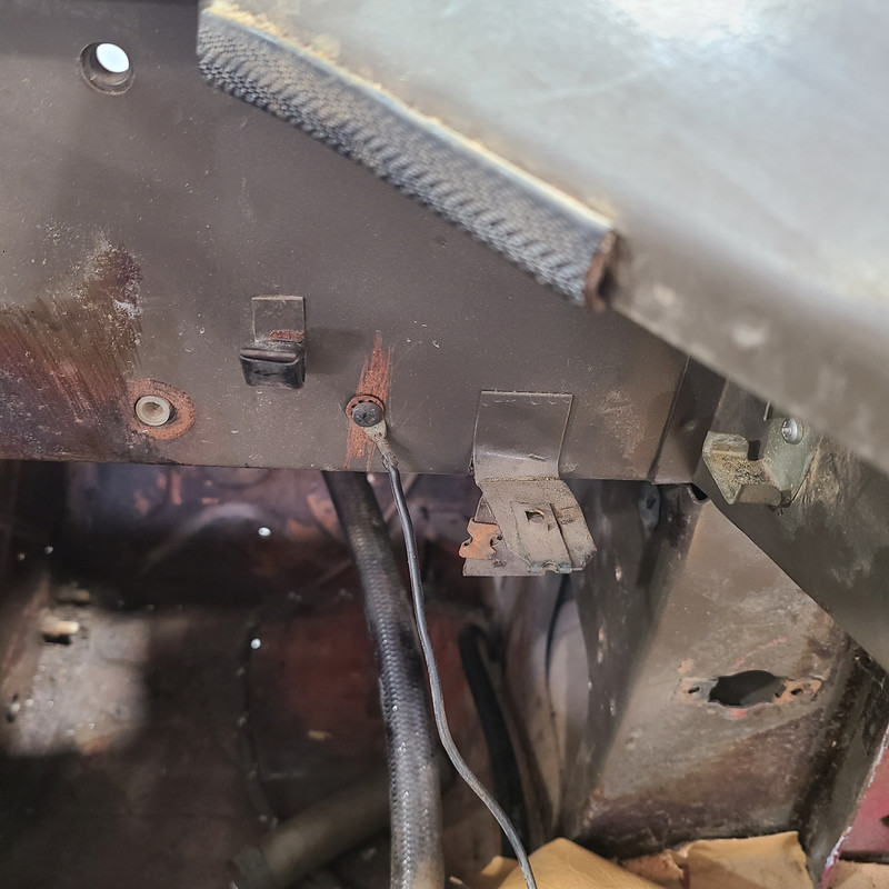

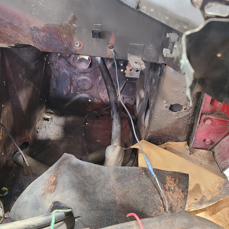

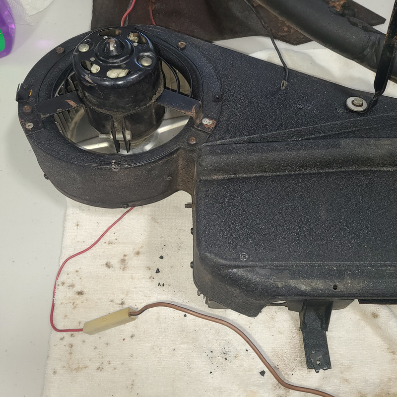

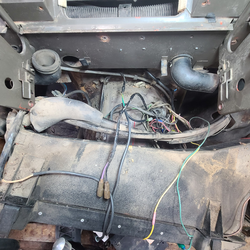

I am in the midst of a total restoration of my Series III and have a ton of photos.
I attached a few here that may be helpful.
Any others (evaporator on my bench, underside of dash, A/C lines, etc) as requested
Craig Balzer
