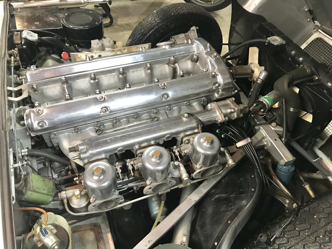

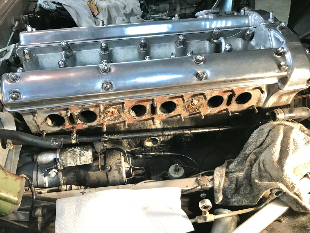

Good evening,
My ‘68 E-type has a 4.2 bottom end from a ‘67 Mk10, with a 3.8 E-type cylinder head and 4.2 type triple SU carbs and manifold. I have a rebuilt 4.2 E-type head I am in the process of swapping onto the engine. When pulling the intake manifold I discovered the plugged round water passages in the head, but these correspond to open water passages in the intake manifold.
Should these plugs in the 3.8 head be removed? I have plans for this 3.8 head for future use on a ‘67 3.8S bottom end that might one day be used in a C-type replica, if I live long enough.
Thanks for the advice

#2 Re: 4.2 vs 3.8 Cylinder Head Question
Post by mgcjag » Sat Feb 11, 2023 9:12 am
Hi Mark....if fitting a 3.8 manifold to a 4.2 head then you need to fit those plugs in the 4.2 head....so i would think its a reasonable assumption that you need to remove the plugs in the 3.8 head when fitting a 4.2 manifold.....on a 4.2 head to 4.2 manifold these are open.......Steve

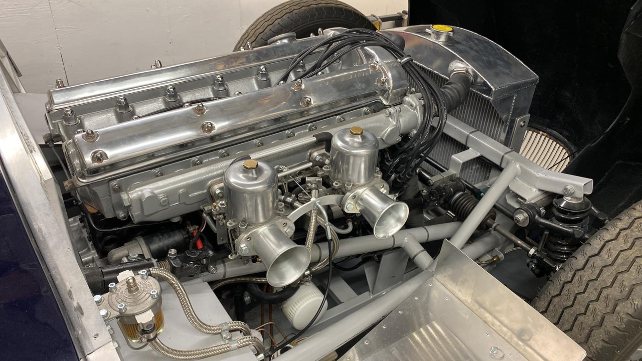

Thanks Steve. That seems to be the common sense answer. Match the cooling passages to whatever intake I would be using. Speaking of intakes, I like this twin carb intake. I think it would look good on a C-type replica. Does anyone recognize it?

#4 Re: 4.2 vs 3.8 Cylinder Head Question
Post by mgcjag » Sat Feb 11, 2023 2:15 pm
Hi Mark ...yes its a Realm C type replica.....xj6 S1/2 manifold with twin HS8,s...very similar to the one im building...im useing HD8,s but with these nice top fakery sandcast look slip on covers :bigrin: ...Steve

#5 Re: 4.2 vs 3.8 Cylinder Head Question
Post by abowie » Sun Feb 12, 2023 12:16 am
As Steve says, looks to be XJ6. There will be a number of holes in the bottom that need tapping and plugging.
I'm using one of these on my Mk2 which has a 4.2 motor.
