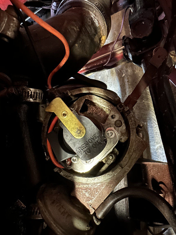

3. Distributor - I have replaced both the main dash loom and the engine loom - originally the ignition was bodged through an additional switch but hopefully it is now via the key. I have a white and a white/black wire at the distributor / coil but it looks as if the distributor has been replaced with an electronic version. This has a red and a black wire. I have confirmed power at the white wire coming from the loom with ignition on and have put this to the + coil terminal. -ive coil terminal has the red from the distributor and the black is earthed. I'm not getting a spark though. I am assuming the white/black is an earth for the distributor but not sure.

Photos really help.....take the dizzy cap off.....is it electronic? or a module instead of points?....numerous dash wireing photos if you google https://www.google.com/search?q=e+type+ ... &prmd=isvn ..Steve

Still won’t start and no spark. I have been reading up and it looks as if the white wire should go to the coil as this is the ignition live. Red from the distributor (below does look like a replacement electronic version) also goes to coil + and the black from the distributor goes to coil -. Not tried yet as I don’t want to break the distributor but will later today. Seems the white with black tracer is the earth when using points but not needed for the electronic version…

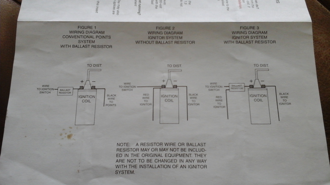

Looks like a Pertronix unit? Typical wire diagrams from pertronix

Post by cmdrew » Wed May 03, 2023 4:35 pm
My thanks Steve, this worked perfectly and the car started for the first time since I got it using the key. Previously there was an isolator key and a separate switch to enable the coil.
