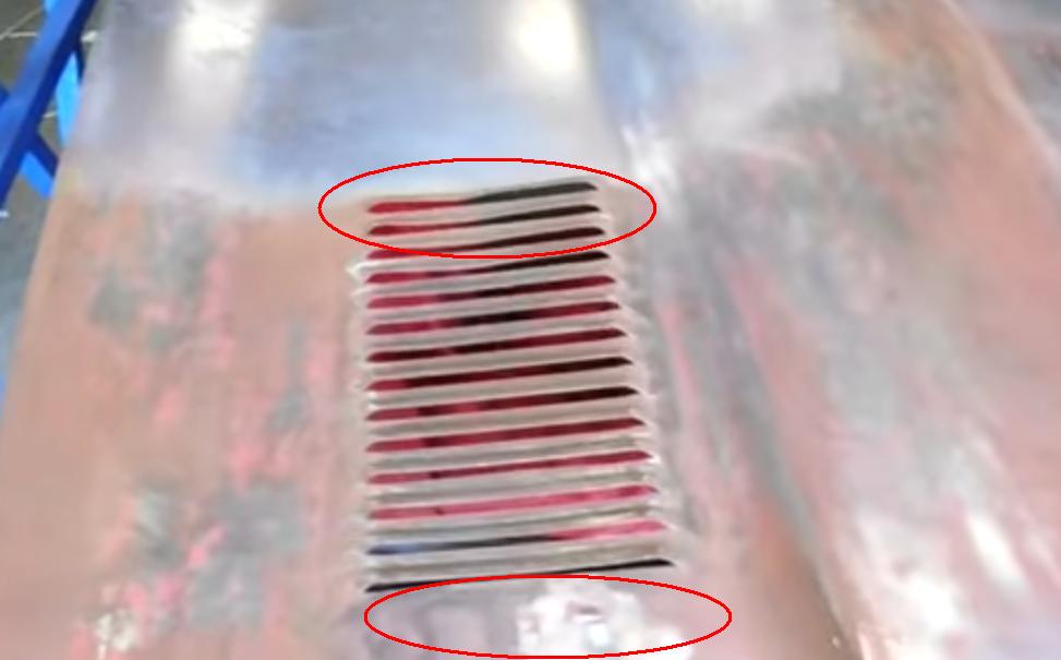

About to start restoring my bonnet and apart from the rust, some of the louvers are bent.
Are there any do's and don'ts when tackling this problem?

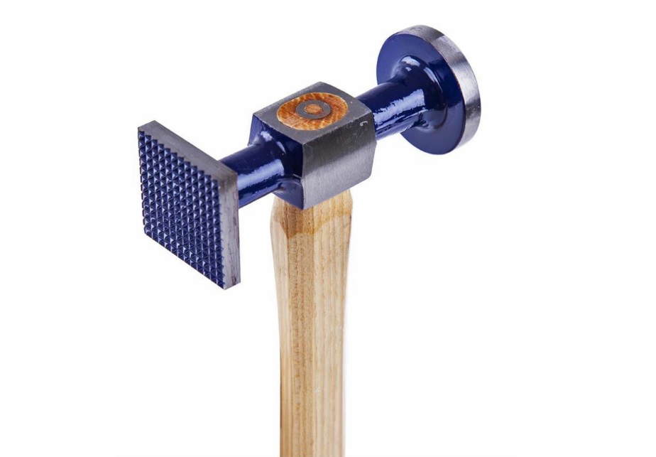

#5 Re: Series 2 Bonnet Luvers
The following picture is of a Shrinking Hammer, which is defined by the checkered face. In my experience, it's a misnomer, as this hammer will stretch far quicker than a smooth faced hammer. Accordingly, I would never use this type of hammer when Hot Shrinking. For those not experienced with making a Hot Shrink, a safer tool to use is a Tinsman Mallet, or a hammer with Nylon faces.
#6 Re: Series 2 Bonnet Luvers
Bill,
I have had a shrinking hammer for more than 30 years and have never used it. When I heat shrink metal I use a smooth face hammer. I have never thought of using a tinsman mallet, wouldn't the hot metal damage to the mallet?

#7 Re: Series 2 Bonnet Luvers
Denis Wrote;
No at all. The Mallet is in contact with the hot spot for such a short time and as the Hot Shrink exercise is over in just a few bows of the mallet, the mallet is not damaged.
The issue with using a Tinsman Mallet in the area you're going to be repairing, is the relatively large diameter of the head. Unless you can get, or make a wooden mallet with a small diameter head, a Nylon faced mallet with a circa 30mm diameter head would be a better choice. The Nylon won't be damaged for the same reason as for the Tinsman Mallet.
Where many go wrong when attempting to Hot Shrink a full area using a planishing hammer, is that they end up stretching the metal more due to the plastic state of the hot spot, which is easily stretched.

Bill, his July video update in the restoration section will show you.

Geoff Wrote:
Hello Denis,
From the image following, captured from your video, I very much doubt that the damage to the louvers shown in the Top Ellipse will need any shrinking and you could easily make it a lot worse if hot shrinking was your first go to method. I would be using either a length of wooden dowel that fits the inside radius of a good louver, or shape the end of a circa 5/8" x nearly as wide as the louver, to the inside profile of a good lover to use as a punch from the inside of the bonnet. You will see that the damage to the forward louvers shown in your video will straighten out quite well, being only bent, not stretched.
The area shown in the Lower Ellipse is where shrinking is often required to get a nice looking bonnet. It's common for this area to be stretched on the bonnet when the cars were new from the factory. I suspect that such bonnets had the louvers cut and formed when the tool was reaching its last legs and the result is a greater curve in the area shown in the Ellipse than at the rear edge of the bonnet. The peak of the curve will always be closer to the raised edge of the louver than at the extreme ends of the louver, but when the gap between the peak of the area in the ellipse and the louver is profoundly diminished, compared to the gap at the end of the louver, then its a clear indication that the area in the ellipse is stretched.
When the curve in this area is greater than at the rear edge of the bonnet and therefore stretched, the alternatives are to leave it as factory, or hot shrink the edge close to the louver.

#12 Re: Series 2 Bonnet Luvers
Bill,
Thank you for a very detailed analysis. Shrinking was never my first option and I was hoping that most of the louvers could be straightened by other methods. As for the area in the second ellipse, it does appear to be stretched but I couldn't understand how that might have happened. As my vehicle left the factory in December 69, the worn bonnet tool fits well with your explanation.
Armed with the information you have given, I am confident that I can repair the louvers.
