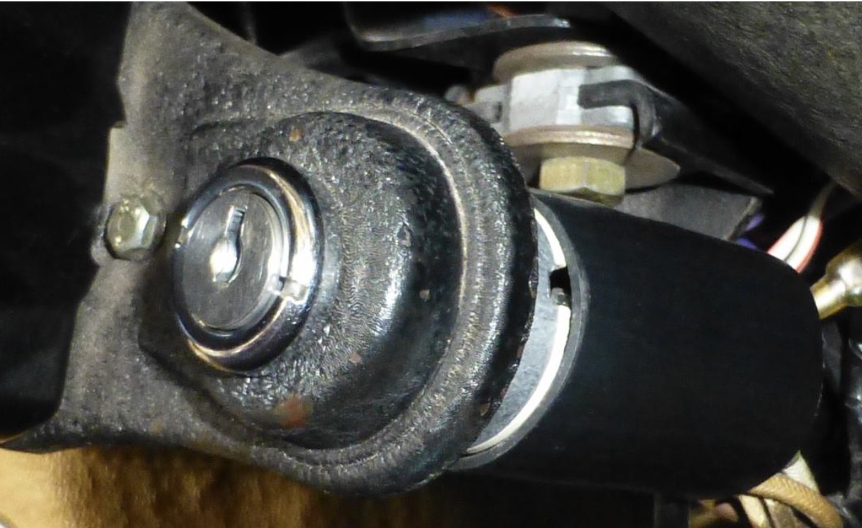

Hi All,
My 1970 UK Coupe has the Circular type ignition switch without the steering lock. It appears to be the original unit and shares the same key as the doors. It is fixed to the underside of the dash with a home made bracket. I would like to replace it with the correct bracket which I think fits to the steering assembly. Having researched this matter, most contemporary cars seam to have the steering lock version (of which there seems to be different versions). Is this bracket still available as all the main parts providers seem to only offer the Steering lock version? I have seen photos of what appears to be the bracket I am after but have been unable to find one to purchase. Am I correct that some S2s didn’t have the steering lock fitted?
I have bought and restored a Britax combined steering lock and switch assembly that is contemporary with my car but would prefer to use the original non steering lock version.
Any help appreciated.

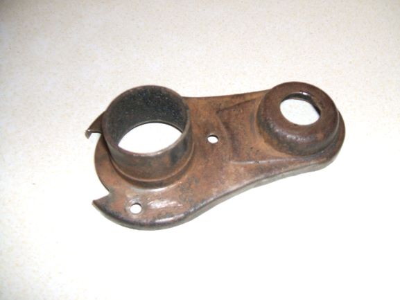

Hi.. ...yes the steering lock can seize iv had one 40 years ago that had to be cut off......but its not a common problem.....you dont even have to use sheer bolts you can use standard if needed....Steve.....Edit...just found lots of info here on the US Jag lovers forum that should help....https://forums.jag-lovers.com/t/ignitio ... mma/395261
This is one type of bracket that slips over the column to hold the switch

Post by tinworm » Wed Nov 11, 2020 4:38 pm
There ya go - pm me if interested.

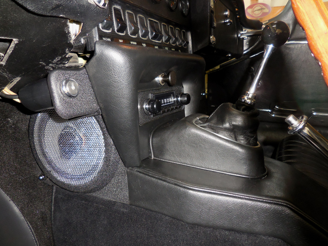

I have a US spec early 69 FHC that came with A/C and it doesn't have the steering lock ignition switch. The A/C was removed by a PO. As far as I can tell some of the S2 cars that came with A/C did not have ignition lock switches because of the length of the evaporator and the ignition switch was attached with a simple plate to the end of the evaporator controls.
My evaporator was removed so the bracket was bent 90°and attached to the new radio console.
Here's a photo of my switch bracket that looks stock.
Andy

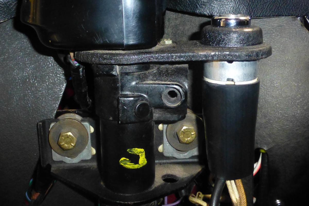

Just putting up this view for Darren of a US S1.5/2 car. The indicator and the ignition switch housing are reversed on a UK car - meaning a small modification to the ignition switch bracket (to allow the wiring to pass through) The steering lock casting - which is unused in this instance - is visible.

Just pointing out my S2 bracket above is the LHD version - just to clarify.

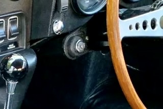

I seem to have started something here - thanks for all the feedback and interest. As Barrie has stated his bracket is for LHD. I can only assume there was a RHD version, as I have seen photos of RHD installations as seen here.
