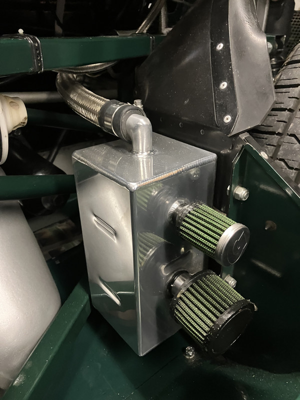

This is where my engine breather goes to the catch tank on my Series 1. I bought the alloy catch tank, modified the inlet to take a braided hose from the engine breather outlet, plus added an extra outlet so both filtered outlets let any vapour out to be potentially drawn into the Webers. I have a drain plug in the bottom which needs draining each season to get any condensed water out.
Dave
