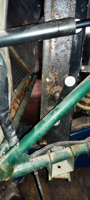

Thanks for all who helped me last time. T bought an e type substantially complete but missing a few bits. I am still having problems with radiator fitting.

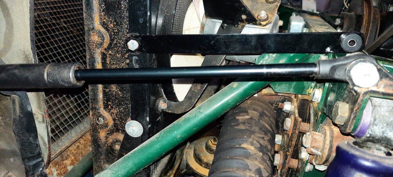

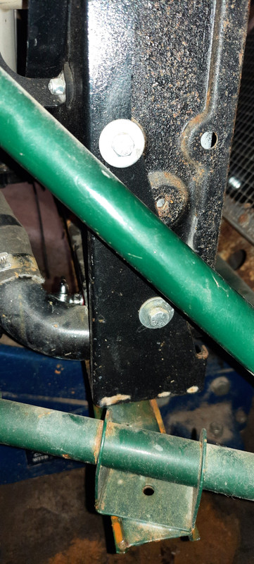

I bought the (missing) top brackets & supports from Martin Robey but as you can see with the rad upright as per photos so the top hose is in the correct position, they appear too long. The bottom brackets & hoses appear to be correctly fitted.
Although the car has Webers I'm led to believe they use a standard top hose
My questions are :
Are there more than 1 set of holes for mounting the bottom bracket to the crossmember?
Should the grommets be fitted through both the brackets and supports as the larger holes seem to indicate?
When upright the rad fouls the bonnet on one side. the bonnewt fits correctly si is there any sideways adjustment on the rad?
Although I could solve this by cutting the brackets down & slotting the bottom mounting holes I would much rather do it properly.
