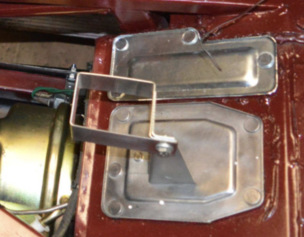

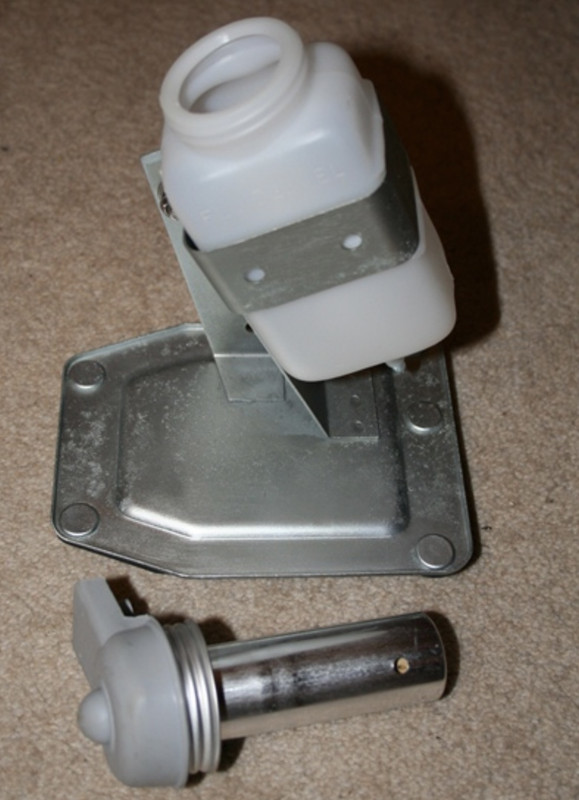

Many thanks for that but I'm talking about the single reservoir on the left as viewed from behind

#4 Re: Brake reservoir bracket
Post by caveman » Fri Apr 26, 2024 8:33 pm
Would have posted this earlier but duty called;

caveman
Posts: 712
#5 Re: Brake reservoir bracket
Post by caveman » Fri Apr 26, 2024 8:38 pm

#6 Re: Brake reservoir bracket
Post by Beechbum » Sat Apr 27, 2024 8:24 am
Thank you very much. That's what I needed to see. Cheers Steve 👍
