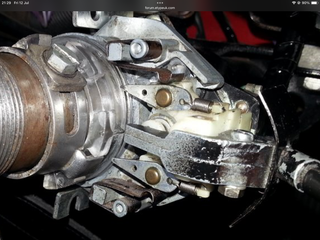

Could anyone please tell me the correct position for the plastic indicator cancelling ring. I assume the cancelling tit faces the centre of the switch with the steering straight ahead but I'm happy to be put right if it's not. Many thanks Steve

Hi. Thanks for the link but unfortunately not. It can go in any one of six positions. The old one was smashed. Cheers

This picture may help, although clear not white, the cancellation tit is in the middle of the two pointers with wheel(s) straight ahead.

Yep , that's confirmed it. Many thanks 👍
