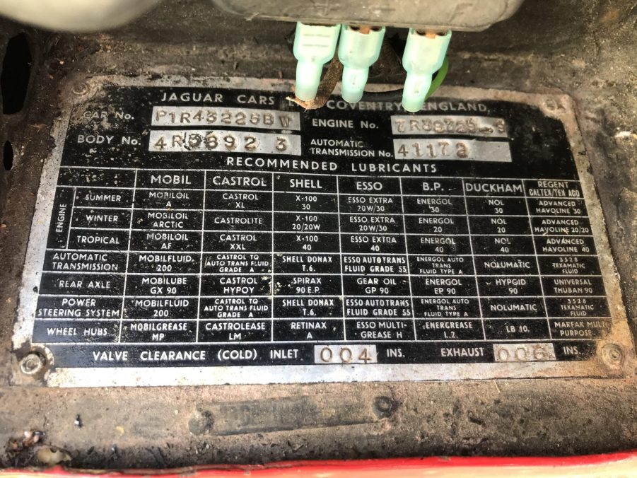

If your car left the factory with power steering the Car Number will be prefixed with a 'P' like this one.

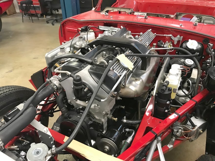

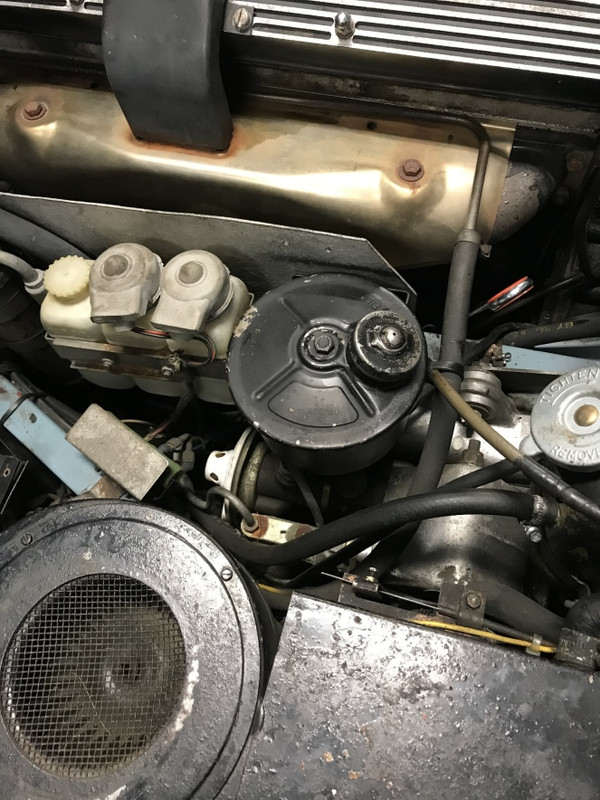

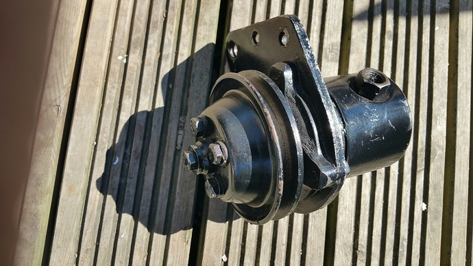

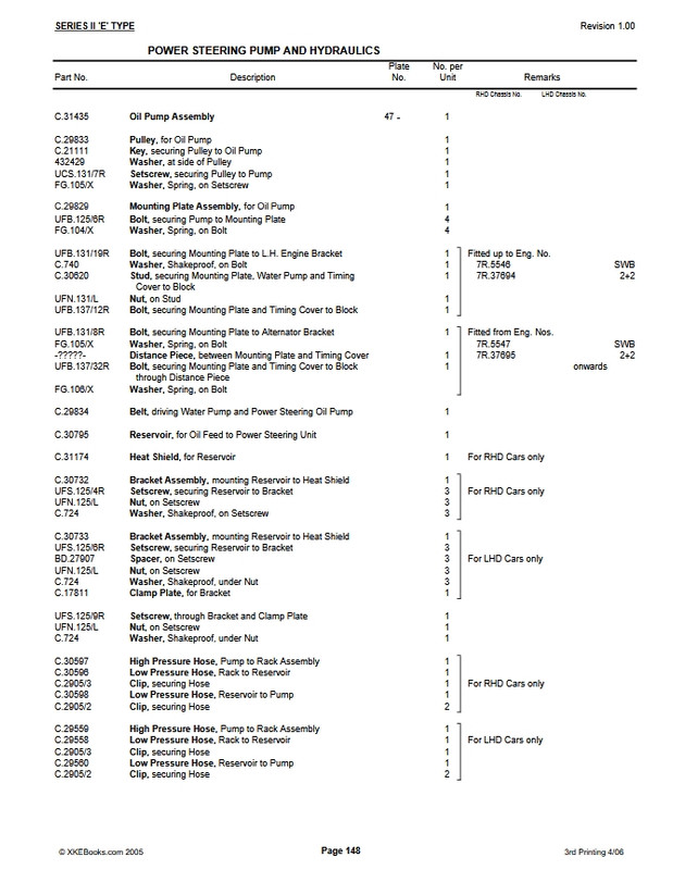

The S2 had a Hoborn Eaton pump and remote reservoir. S3 had a Saginaw pump with integral reservoir.
These images may help and are of LHD S2s.
