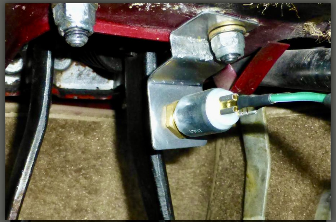

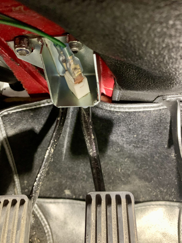

I gave up with getting the old brake switch off in the engine bay. I bought a Normally Open barrel switch and fitted it in front of the brake pedal. I made my own metal bracket - fixed in place with the two nuts to hold the brake/clutch unit in place in the engine bay. New cable taken directly from old brake switch through existing hole in bulkhead. All is safe and neat. Brake lights come on at first press of pedal. Whole job cost me about £5.

The horn electrical connections in the steering column indicator arm are too far down the column for when the push button switch is pushed. Rather than faff with that, I put a momentary black push switch to the right of the radio (there was no cigarette lighter - just a rubber grommet). I diverted the indicator arm wires to the new switch - all works fine. I don't have to move anything apart from my left finger to make the horn work. Whole job cost £3.

I didn't know there was a kit you could buy for the brake pedal switch. I ended up sourcing everything myself with lots of metal bending and bashing in the workshop. All good now though.
I may consider swapping the two Strombergs for two SUs. At least I will be able to adjust air/fuel mixture, which the Strombergs won't allow me to do.

#16 Re: Project E Type starts again
#17 Re: Project E Type starts again
Thanks for the photos. I used the lower photo as the blueprint for mine, but I decided to make it wider so it was held in position with the two bolts, not just the one shown. I was concerned about hitting the switch with my foot, but it's well out of the way. Painted with black hammerite.
Now if I can work out a way to make my feet narrower, so I manage the small pedals better........
