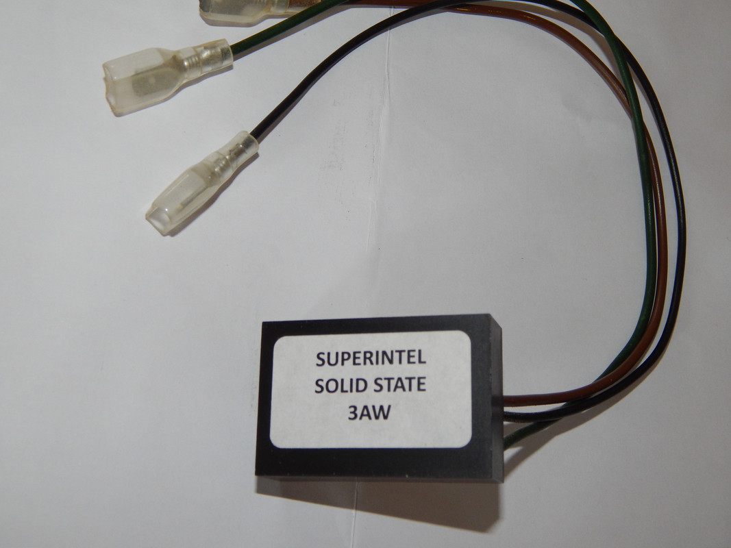

Morning Paul, I'm unable to give any reliable advice as I do not know what type of 3AW unit SNG supply, perhaps they supply a modern unit with electronic protection for the semi-conductors. If you can get a known good one and try it by substitution on your car it may help you decide. I may have a spare one of my own electronic units, I'll have a look later, I did make a batch of them during lock-down and could have one or two left. cheers John.

Hi Paul, I have found a couple of electronic 3AW modules, I'll post a couple of pics when my phone is charged. Just a quick question, does your car have the original alternator fitted and not a modern substitute that does not need a 3AW unit? cheers John.

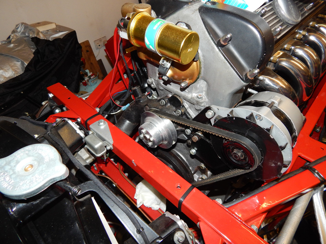

Hi Paul, I think you are getting a little mixed up here, the black plastic small box with three wires sounds to be the 4TR voltage regulator, it is mounted on a small angled bracket below the heater box. You will need a good one of these to be able to charge. The 3AW unit is as you say a unit that looks like a flasher can, this is just the warning light control module for your dash board display. Your alternator should be a Lucas 11AC which needs both of the above modules for it to work. A common mod. is for one of the later Lucas alternators types 17ACR etc. or similar to have been fitted by a previous owner. These ACR units have both the voltage regulator and warning light control built into the alternator and do not require the 4TR or the 3AW units to be fitted. If possible send me a couple of photos of your fitted alternator and we can go from there. I will try to find a photo from my car that may help you id. which system your car is running. cheers John.

Hi Paul, images to follow, hopefully, cheers John.Image[/img]
