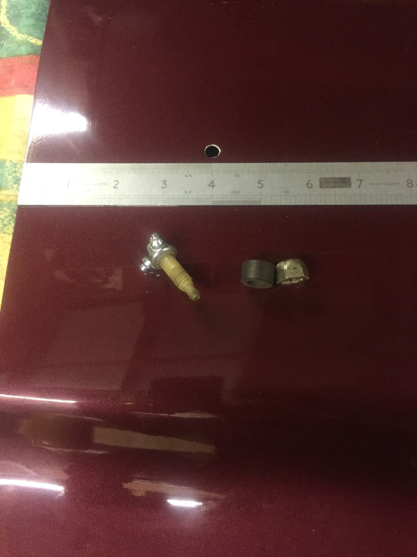

Hi all, new to forum and glad to be here as just got my 1969 S2 2+2.
Preparing for road worthy to get club registration (Melbourne Victorai Australia) and discovered there is/are no washer jets or hose at all! Water bottle and motor all work dfrom rocker switch but just squirts up under the bonnet :(
Keen to determine the correct Jet(s) as this fully restored E Type has no hole in the bonnet as seen on Series 3, and the more foreward windscreen with thin plenum - no hole(s) there either.
So, surveying all S2 2+2 owners for the correct jet(s) type, location and mounting please.
Much apprecciated :)
Frank.

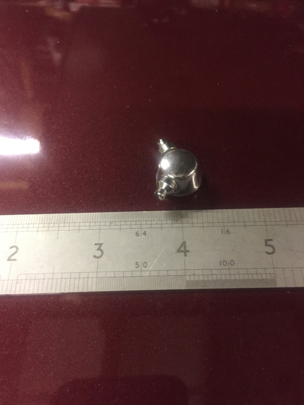

Hi Frank,
The jet is positioned 4 inches from the rear edge of the bonnet on the centre line.
My jet which appears to be original as the car had not been apart previously has 2 jets, on the inside of the bonnet it has a steel spacer 3/8 long and a chrome nut.
Tony

Hi Tony, Thank you for the description and vey handy pictures - much appreciated :)
