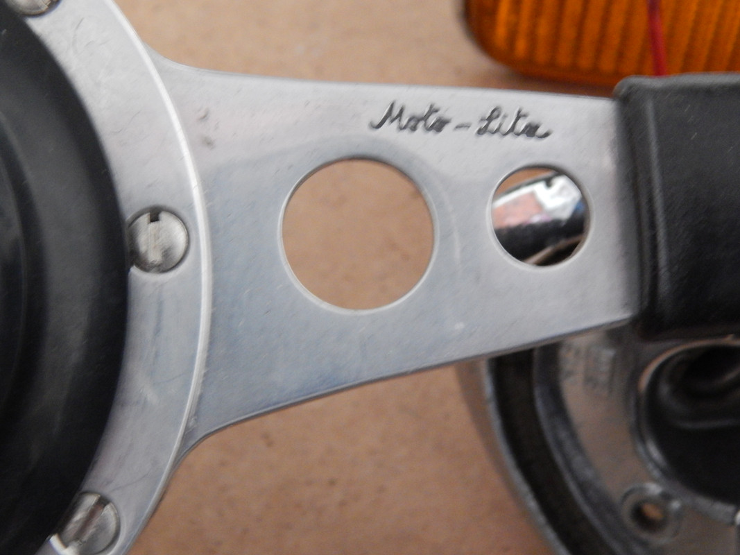

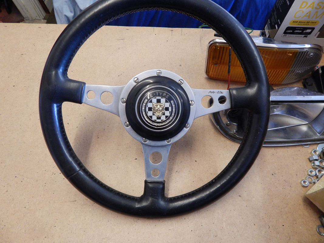

Another solution would be to fit a smaller steering wheel, the standard wheel is 16 inch diameter, Moto Lita and others sell them down to 12" to fit the E type, personally I would not go lower that 14" unless your car has power steering or you have Popeye's arms.
