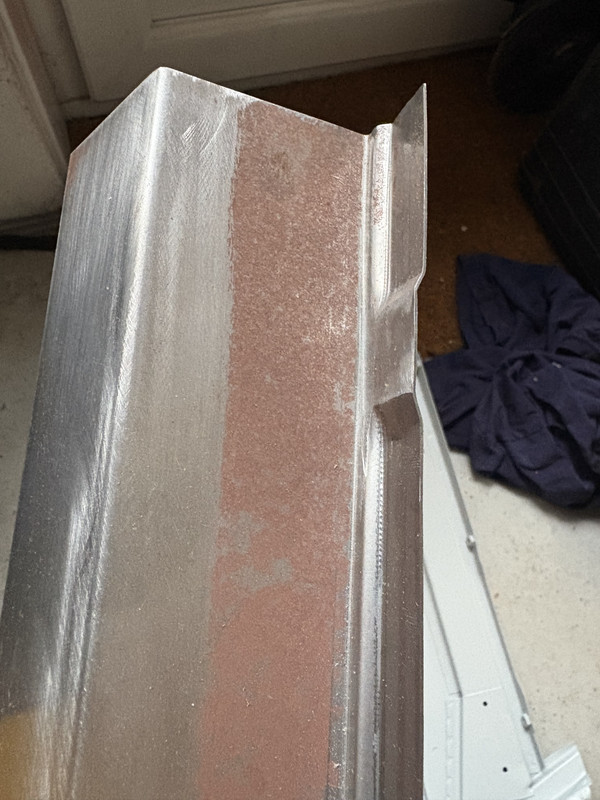

For the series 2 2+2 door - My doors were pretty shot and I have no references for how the door lower drain and door skins come together.
I’m not sure if I notch the skin to go around the drain point.
Could someone provide me with a photo for the original layout?

The repair panels I have are from Chuck
You can see the drain is formed on the same edge that the skin will be formed around. Im just not sure if I have to notch the door skin or if there is another way.
The non 2+2 cars have different drains - they’re a separate item that sits on the frame/skin.
I’ll drop Chuck an email but I’m hoping someone will have a door in original condition that they could quickly take a snap of.

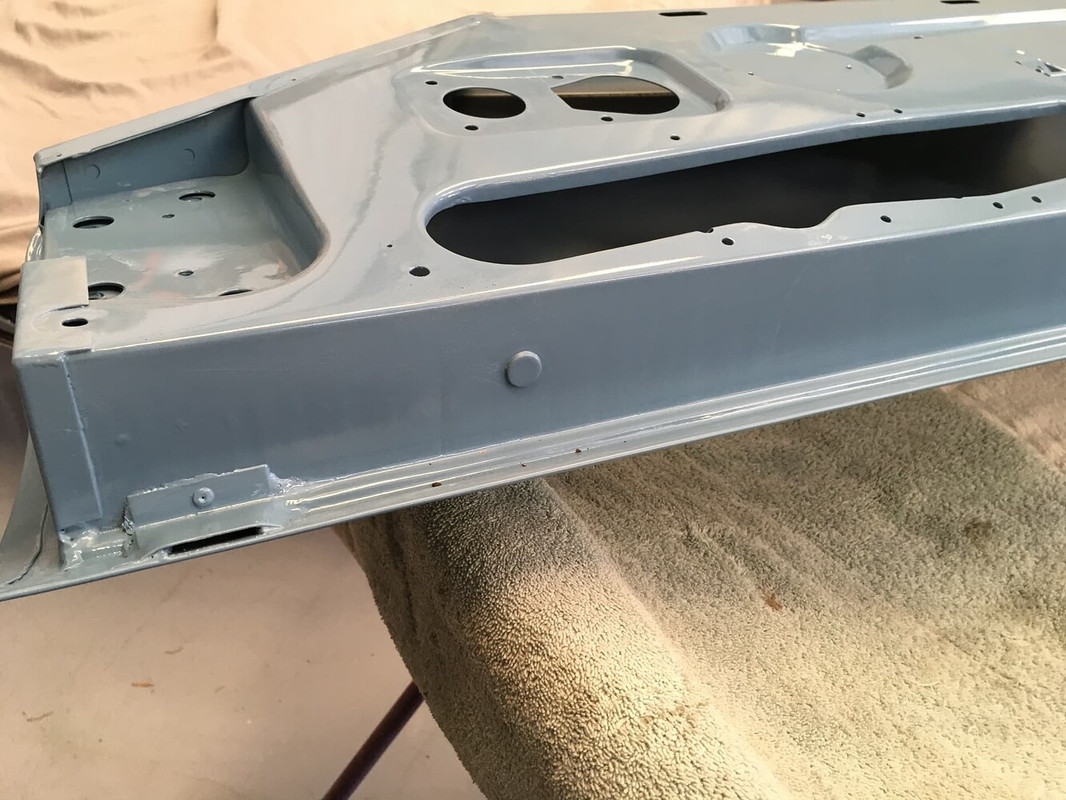

#4 Re: S2 2+2 door drain and skin interaction
Hi Rich....have a look here re door drains..I posted photos of my 2+2 door Door Drains - The 'E' Type Forum https://share.google/obeWZ8owFvMBKj04W and another photo
