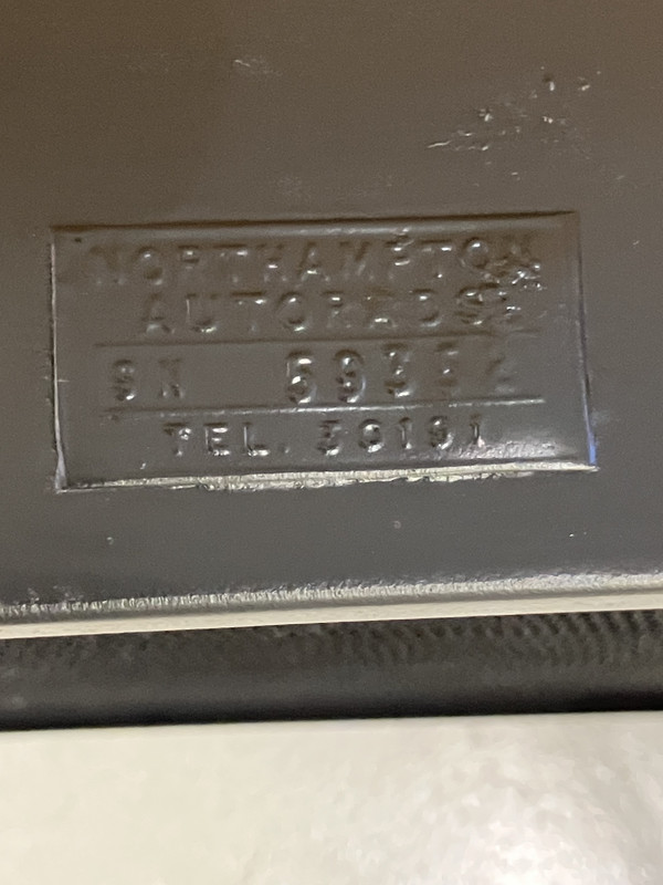

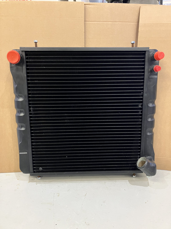

As part of my winter service this year, I went all through the cooling system, replacing all hoses and getting the radiator re-cored by NAR.
I spoke to Andy Hornby there and he could not have been more helpful. The job was skilfully done with a quick turnaround and very well packed.
As my radiator was the original one, I requested the original Northampton Autorads manufacturers plate was retained, which they duly did.
I removed the radiator with the bonnet on and once the header tank and mounting bracket was removed, by putting cardboard protection on the radiator, it was lifted out ok.
