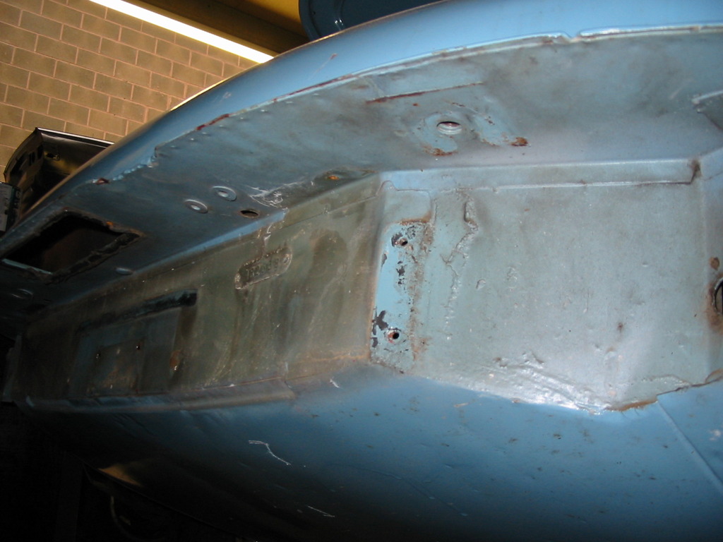

The top one is for behind the windshield, on the a-post. (my guess is only the US had those, on the left on lhd cars. Could somebody please confirm that?)
The bottom one is the body number tag, it is riveted on the body from the rear, behind the tag, on the rh side. You should be able to locate
The original rivet holes?

Correct, the top one is on the A post about half way down the inside, mine is on the left hand side as mine was a LHD XKE S2.nefematic wrote:Bob,

Addendum: I will bring some closure to my own questions by posting this pic of the body tag mounted on a car
