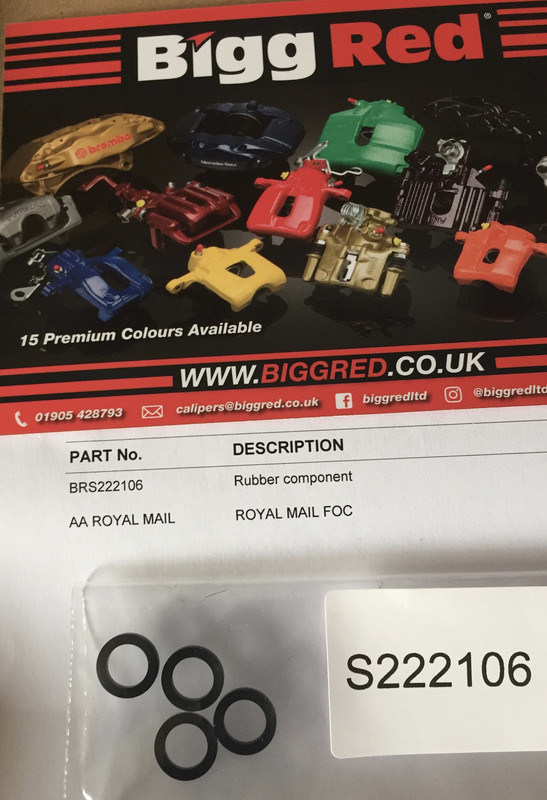

Post by UK Muppet » Wed Jan 27, 2021 2:50 pm
I have been searching for these bridge seals for the past week or so and have spent a number of hours looking at numerous websites. I found they seem to be readily available in the US and only cost cents which is what I would expect. However finding them in the UK is not so easy. Anyway yesterday I had to drop some parts off at a plating shop and I realised I was not far from a company that deals in AP Racing parts among others and so I called in on them. When I mentioned Girling calipers the reply was " ooh no, we only deal with AP and your not supposed to split calipers so we would not be able to get them anyway". They then suggested I try Brakes International which was a couple of miles away. Better result, they knew exactly what they were and the part number but had no stock but would order them from Denmark! As I was leaving one of the guys said try Bigg Red in Worcester, they should have them. So got in the car found the phone number and called them. I was dealt with very efficiently and politely and asked how many I wanted, I said I needed 4, gave card details and address and the guy said he would post them. To my surprise a box appeared at lunch time today containing the 4 seals. A bit more expensive than the US but less than some suppliers I found by quite a margin and they did not charge for postage so I was very pleased. :bouncyyellow:

@ UK Muppet
Hello Tony,
Searching the Biggred website for Part No. BRS222106 and all derivatives down to 222106 results in:
"No products were found that matched your criteria"
UK Muppet
Posts: 97
Joined: Tue Feb 19, 2013 7:43 pm
#19 Re: where to get the small seals between 2 brake caliper halves
Post by UK Muppet » Wed Feb 03, 2021 2:16 pm
Hi Bill, I made a search myself with the same results as you, so no answer other than the website is not brilliant. I found it a little troublesome to use.
I can only say calling them did the trick, I just said I wanted bridge seals for Girling calipers and they asked what the size was due to there being 2 sizes. I got them the next day with the part number shown on the bag and invoice. I didn't make it up.
