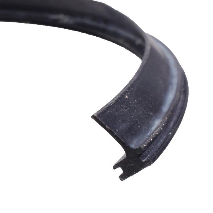

Looking at BD19397/m (see picture below) I think the lip is too thick ( should be a lip of a windshield wiper) and maybe thats why they have closing /opening issues.
Parts are ordered, and we will see.
