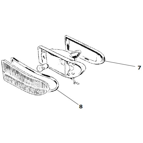

S2 front turn signals. I am referring to the gasket between the housing and the bonnet metal. Item 7 below.
I can't find a way to install these. .
I don't t think the housing is supposed to fit INSIDE the lip of the gasket. If I put the housing on top of the gasket, there seems to be very little contact area between the gasket and housing.
What are your experiences? Any advice?

I can't be certain that the pair of US spec '69 front indicators I have are original but I'm pretty certain they are. The item 7 gasket on those is a grey foam with uniform thickness across the whole gasket right up to the edge so there is no "lip" to be inside or outside.
Doesn't directly answer your question but I hope it helps.

Item 8 on my car is indeed a foam gasket. Item 7 (pic below) is molded rubber, not foam. As you can see, it has a very narrow profile along the edges mating to the housing.

On my car the curvature of the light matches the plinth on the bonnet so there's no need for a gasket that builds in thickness towards the curved end as the one in your photo does. I'd offer your light up to the bonnet without the gasket and if there is no gap between the curved part of the light and the bonnet you need a flat (foam) gasket, not the rubber one you have.
