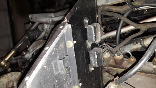

Having just stumbled across this post, can I take you right back to the beginning? That picture of your ign switch is a bit troubling - it looks as though that rivet at the top has got hot at some point, and maybe also the one at the bottom right. This is suggestive of a bad connection within the switch, and when these get hot they tend to soften any springs that may be in the vicinity, making the problem even worse. Then you can end up with intermittent faults and annoying things like that. Just a thought.
