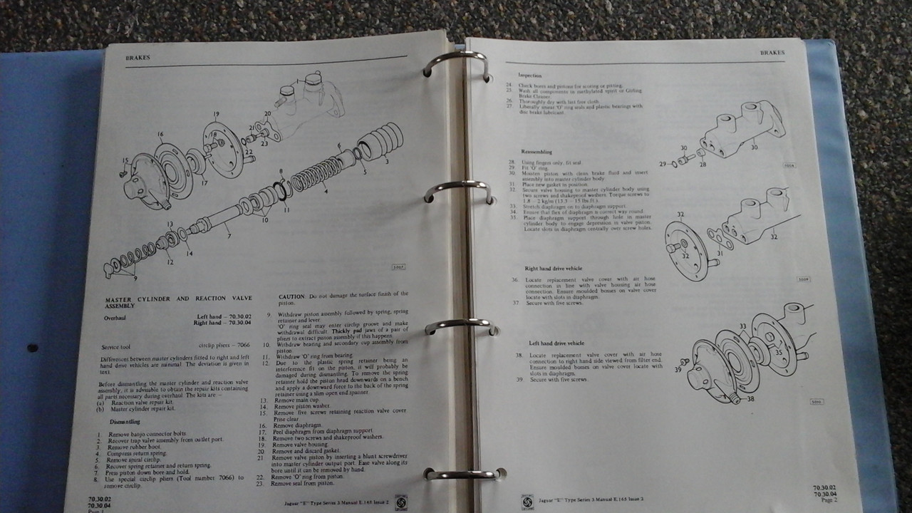

Hi Steve, Yes I do have a workshop manual but it doesn't seem to cover my problem. One thing that has occured to be, it and I quote, " when reassembling the item (34) Ensure that flex of diaphragm is correct way round" What is the right way round ? There is no diagram or description, and I did not take note of it when I removed the original, many months ago.
I have today removed the master cylinder, again showing a small amount very dark fluid on the inside of the diaphragm like rusty brake fluid. I took the small reaction valve out, cleaned it thoroughly and have replaced it. I'll try starting the engine prior to re-bleeding to see if that makes any affect, if not, then I'll re-bleed them only bleeding a system is a labourious job. Try that all tomorrow.

Post by mgcjag » Sun Apr 28, 2019 6:01 pm
Hi Bob...the service manual has detailed drawings of the master cylinder including the diaphragm..
