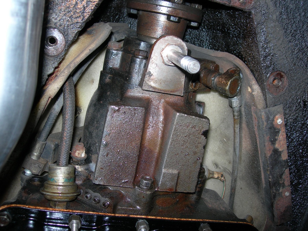

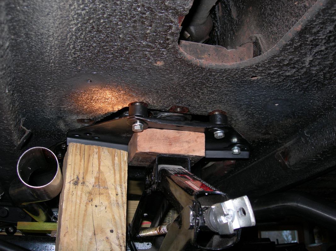

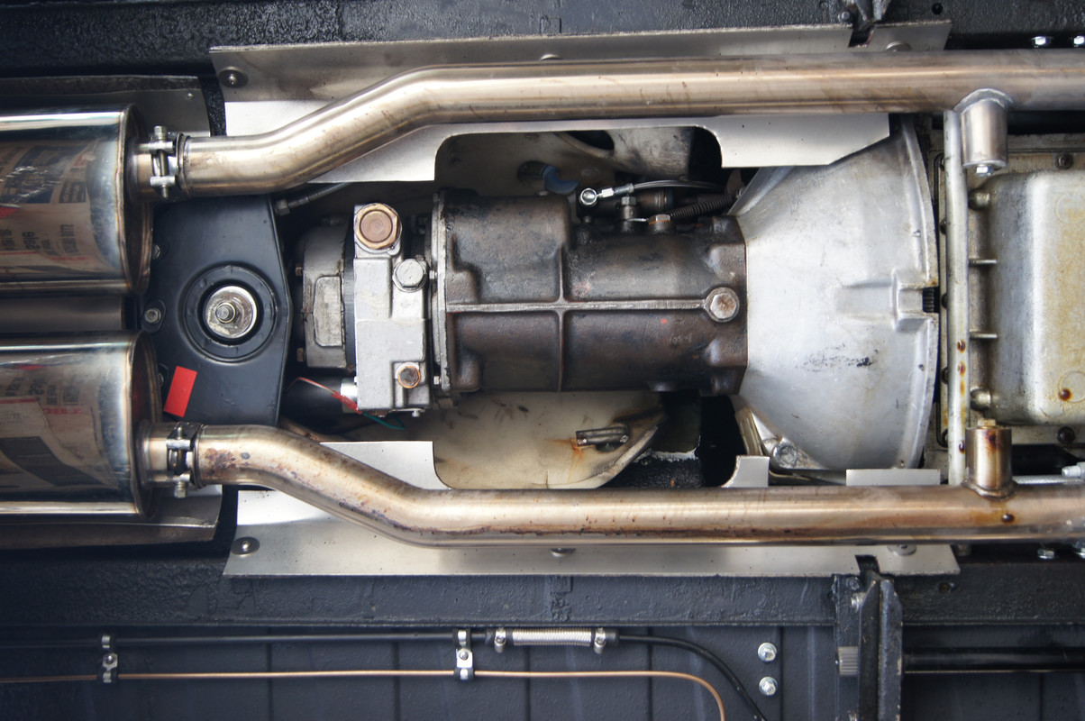

Talking of which, anyone got a pic of the underside of the V12 showing the rear engine/gearbox mounting ?Mine is wrong and I'm not sure but I think the C42202 is missing and the mounting bush (CAC3227*) is missing.
I can't see where the rear mounting bracket fixes.
Bob

Post by Ole-xke1974 » Tue Jun 25, 2019 2:14 am
Hi Bob,
will this help ?
