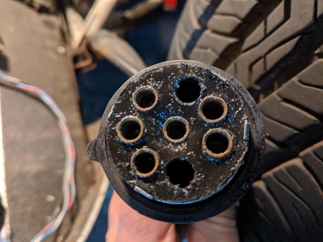

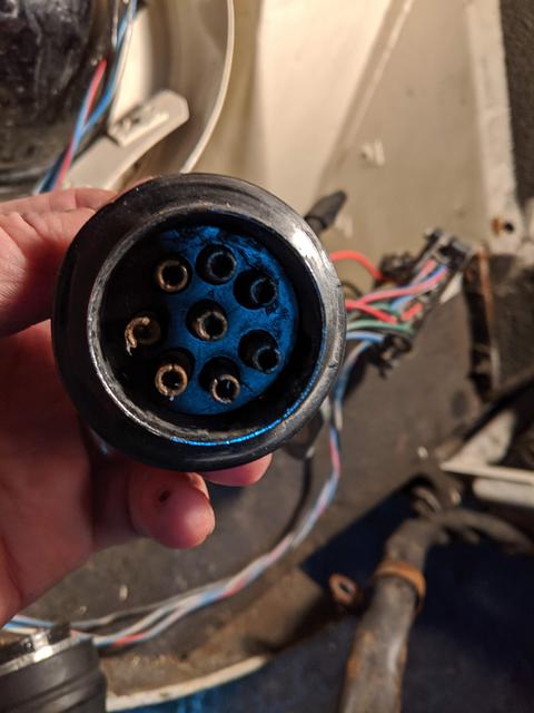

My 8 pin connector cable is missing two metal inserts. Is that correct? (see picture).
The center socket pin shows 12v when the highbeam dip switch is on, 0v when the switch is off.
I tested the socket for low beams, flashers and turn signals and got 12v for all when on. Someone told me the center socket is not used, yet I get 12v there when the highbeams are turned on?

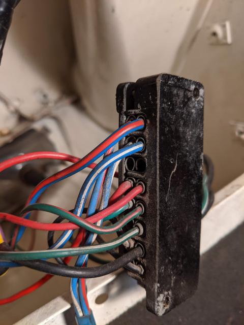

I pulled the large metal cover off the back of the headlight assembly to get a look at the terminal block. Nothing loose or obvious and no signs of corrosion (see picture).
I hate to replace the socket and/or the terminal block, especially when I'm not sure it will solve my problem.
Any other suggestions?

I’m calling the connector with the holes the plug and the one with the pins the socket.
My car is ’72 us spec, I imported it, should (?) be the same as yours. My plug is not missing any metal inserts, each hole on the plug (and pin on the socket) is labelled with a number, 1-8. Holes 1-4 are slightly larger than holes 5-8.
It may be that a previous owner of your car had some issues that he fixed by making modifications…
You can tell what the wires do by their colours, as per the wiring diag, as Chris advised, you can download this from the forums knowledge base.
https://www.dropbox.com/s/a4ubnltt94dnq ... g.pdf?dl=1
Blue with white trace = high beam
Blue with red trace = low beam
Red = sidelamps
Green with red trace = left flasher
Green with white trace = right flasher
Black = earth
You can verify any part of a circuit by continuity test. E.g. between a pin on the socket and a terminal on the headlight plug. Isolate the circuit and use an extension wire to connect both ends back to your multimeter and measure the resistance. If the wire is good you will get a resistance of a few ohms. If the wire is broken somewhere you will get an “error” or open circuit reading.

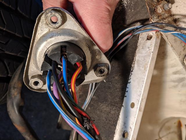

First, thank you Colin. I really appreciate the help and your patience with me. I'm enjoying the learning experience and looking forward to solving this problem. When I started I new little or nothing about car wiring and am only slightly better now, BUT I am getting much better at reading wiring diagrams.
OK, I think the problem is two parts. The piece that 'plugs' (holes) into the socket (pins) is missing the metal inserts and not able to make the correct connections. Secondarily, the 'socket' has been modified and doesn't match the wiring from the harness.
I think you are correct that this was modified by a previous owner and I'm not sure what they were trying to accomplish. On the socket side there is a short 'purple and yellow' wire coming out of the center pin (see picture) it is then connected to a 'red and yellow' wire and then sent back to a different pin. This makes no sense to me at all.
I disconnected the 'purple and yellow' wire from the socket and connected the blue and white headlight to that pin and 'voila' high beams. However, low beams wouldn't work.
So, my plan is replace the 'plug' and the 'socket' and put them back to the original wiring diagram. The wiring harness looks original so I'm hoping the wiring inside of it is original too.
I'm thinking as long as the wiring from the plug matches the socket, I should be good to go.

Seems to me you have proven that the problem is exactly as Ole predicted, broken pin/hole connections in this plug.
Seems PO work around was to reroute the headlight supply from pin 2 or 3 to the centre pin 4 – via purple/yellow, red/yellow wires on the back of the socket. If this is correct u should find that there is similar rerouting on the back of the plug?
That low beam stopped working could be a lot of things, including that the PO found not enough reliable connections to run everything, so he kept low beam and didn’t connect high beam.

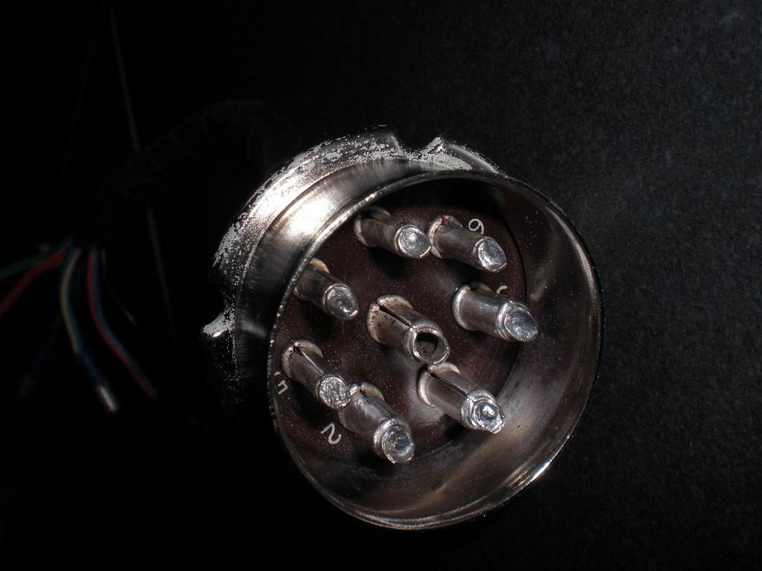

#15 Re: High Beam Headache; Comment on #13: connector version SIII
Hi Mike,
series III has the same connector comprising of folded sheet pins like series I and II, see photo of the refurbished connector of my series III. Before refurbishing it I had to experience the unsatisfactory quality of a repro part with solid brass plugs.
Holger
Holger

Thanks Holger - that is interesting and your refurbished connector looks beautiful.

Thought I'd post a final note.
I ended up replacing the terminal block (it fell apart into pieces when I handled it).
Then I replaced both sides of the non-original 'replacement' wiring connector (nothing original here apparently). That said, everything works now as it should.
I sure like the look of Holger's refurbished plug, but I didn't have the original to refurb and I couldn't find an alternative?
Thanks again to Colin and Ole for the guidance.
Cheers,
Cheers,
