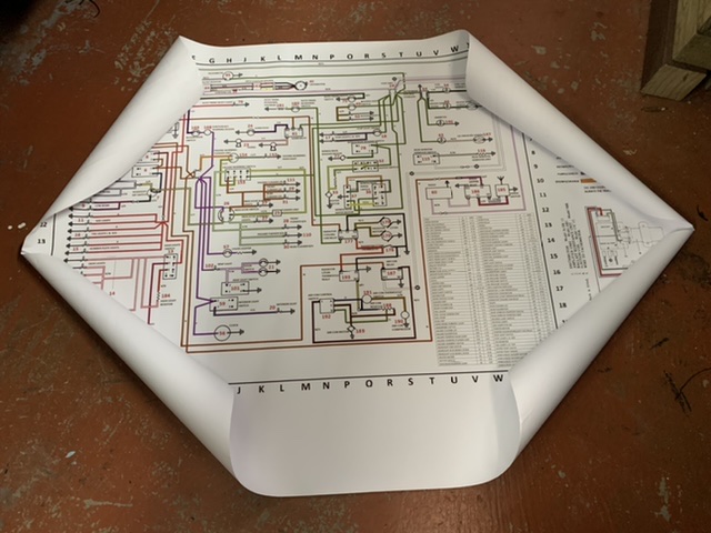

I have a series 3 FHC, RHD UK spec, no air con or SBW system and I re-wired it completely. The wiring diagram on here is the best I came across, and I bought both the Coventry Auto Components book (which I found incomplete, sadly) and a colour wiring diagram, I can’t remember exactly where from. The relay you describe does not seem to be in any of them. The wires on the non fused side of fuse 6 and 7 are sometimes connected to the opposite one to that shown in the diagram, but as they are linked anyway by a short white wire, this doesn’t matter electrically speaking.
The only white wire from 6/7 to a relay is to the air con relay connection W2, but no light green cables come from that relay. Another white cable leads to a line fuse behind the dash, this carries on with a white lead to the rear window heater/demister switch, on my car this is actually white/black, which is supposed to be the colour of the lead from the switch back to the screen. Possibly someone fitted a relay for the demister, which I would guess draws a reasonable current. Of course anyone could have modified the loom for many reasons.
A couple of other possibilities. The car may be wired with incorrect colours from new, it is a Jaguar and that would not surprise me. It could be to the air conditioning relay, but the system was later rewired with light green, alternatively the seat belt warning system may be wired with different colour to original but should take fused power from fuse 4 and 3. A close look at the wiring diagram shown on here reveals that three white leads supply power to the SBW system, one into the unit (at least that's how I interpret it) and one each to the SBW Gearbox Switch and the SBW relay, connection C3 (connections 1, 7A and 7C of the SBW system as shown on the diagram). I think these are pre fuse, but after ignition switch.
Hope that might help, here’s my colour diagram, printed on a plotter and somewhat difficult to roll open!
I still prefer the black and white one on here, I find I very quickly remember the colours and codes and the drawing is simply easier to follow without the distraction of colour.

The SBW box sits right in the middle of the dash between the two banks of fuses. It has a circular plug going into the box and a "Smiths" label visible on its front face. The relay you show is part of the SBW system and is shown on the s3 wiring diagram from xkedata.com /resources in the dashed box on the right hand side of the diagram. If you look at the wiring diagram, you'll see that it was designed to intercept the starter relay connection via the park/neutral switch relay winding grounding on automatic cars, so may be redundant or implemented via what the diagram describes as the gearbox switch if your car is manual transmission - see connection "7c" on the diagram.
In any case, you can bypass its effect by rearranging the four white/yellow wires under the dash and unplugging the round SBW plug if it is inhibiting your starter relay.
