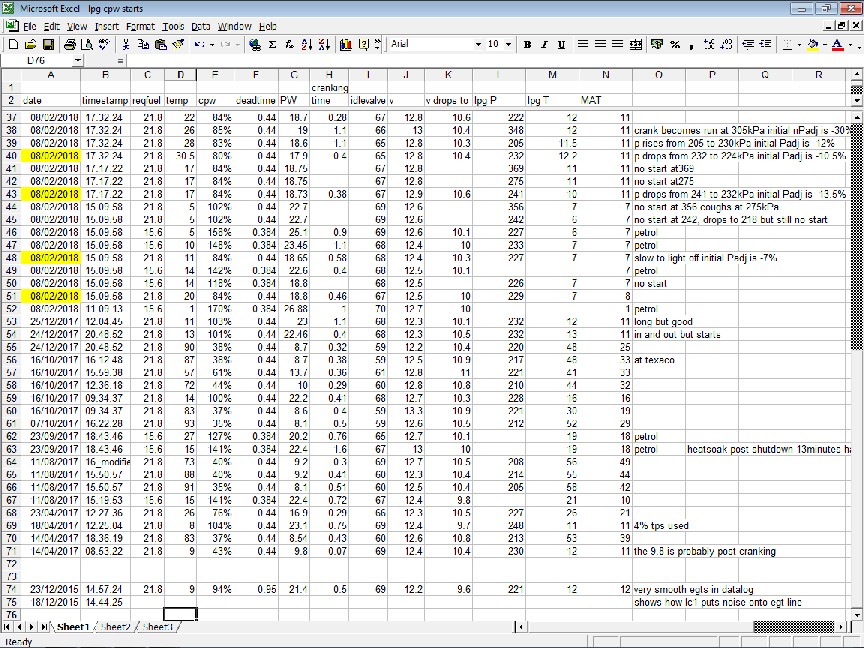

Aside from having to prime a high pressure pump, you ought not be a significantly worse position than the rest of the v12 fuel injected community. With a view to that, appended is a screenshot of a table of the car starting at different temperatures on both propane and on petrol. Your data will be different but the trends ought to be the same. It's a v12 HE with skimmed heads ~13.5:1. Cranking time is generally ~0.5seconds and the slowest was a heatsoaked 1.6 seconds.
cranking pulsewidth start comparisons.jpg (252.78 KiB) Viewed 3970 times

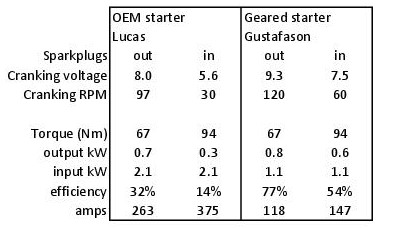

Yep, more than warm. Didn’t test the OEM starter with the plugs in for the full 10 seconds, stopped at the first whiff of lacquer being cooked. So, from that test the reported cranking speed (30 rpm) is half guess.
Staying on topic just for the moment. What I’ve demonstrated conclusively is that, compared to OEM starters, a little geared “high-torque” starter will: spin your engine faster, draw less than half the current, not drag down yr voltage nearly as much. I.e. significantly better performance together with massively reduced stress on the car’s electrical system. Game. Set, Match, little high-torque starters are hands-down better.
You say: “A high torque starter uses the same energy as the old Lucas to fire up the engine because the same net work is being done.” Imo not true. A high torque starter uses LESS energy to do the same or more work. Because it is more efficient.
Voltage, RPM and torque were measured.
Output kW = Torque x 2 x π x RPM / 60.
Input kW = starter motor rating.
Efficiency = output kW/ input kW.
Amps = input kW /voltage.
The main point you make is that, with properly sorted low-pressure EFI, the engine can start so quickly that a high torque stater motor would be of little benefit. Imo this would mean the converse should also be true, anyone with a carb’d car should find a high torque starter beneficial.
I will be high-pressure EFI, 6 to 10 times higher than your relatively low pressure EFI, so your point may not be applicable to me either. All your explanations assume that the injectors open, what if they don’t? What if, due to very low cranking voltage together with the very high fuel rail pressure, the injectors stay firmly shut, not enough energy (voltage) available to open them against the monstrous fuel pressure that is holding them closed? Clearly (to me) this will be less likely to be an issue with a high torque starter.
