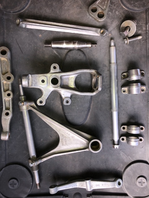

I have dismantled the top and bottom wishbones (see pic) and thinking about restoration finish of these items along with the axle carrier.
It seems that some restorers are having them electro-plated.
However when looking at mine I can see that they were originally black, presumably painted.
Did the S3 come off the production-line with plated or painted wishbones/suspension?
I'm thinking cost to..
thanks to all,
happy days..
Colin

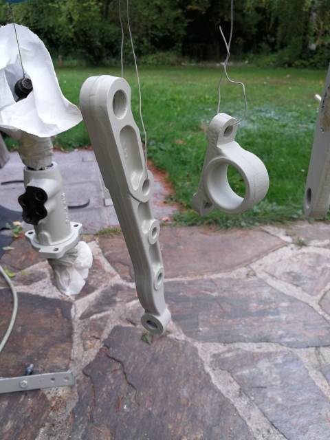

Well, I was told they were plated on all E-types, including the Series 3. I took mine to be plated and he refused, saying that they would not take plating well. I argued, but to no avail. Looking by, I could have gone elsewhere, but instead, I de rusted thoroughly, using a dip, then primed and painted with silver wheel paint. Here’s one of them photographed just now, about 12 or 13 years after I painted them. You can see pitting which was there before the paint application, but as you see, a cheap and effective solution.

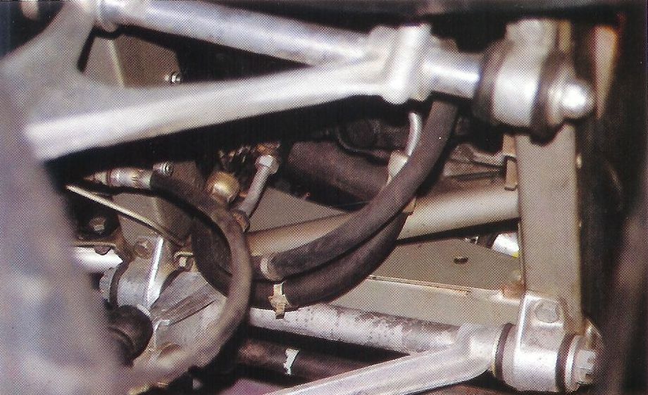

It is known that some early S1 cars left the factory with black front suspension components but otherwise I believe bright cadmium plating was used until the end of production. The last S3 was retained by Jaguar and pictures, taken at Robey's during restoration for the E-Type's 40th anniversary, certainly show a silver rather than black finish prior to being replated.

That's the way mine looked before I thoroughly cleaned them and painted them with 2K primer and 2K frosted finisher. I told myself that plating still could be done later but I am very happy with the painting.

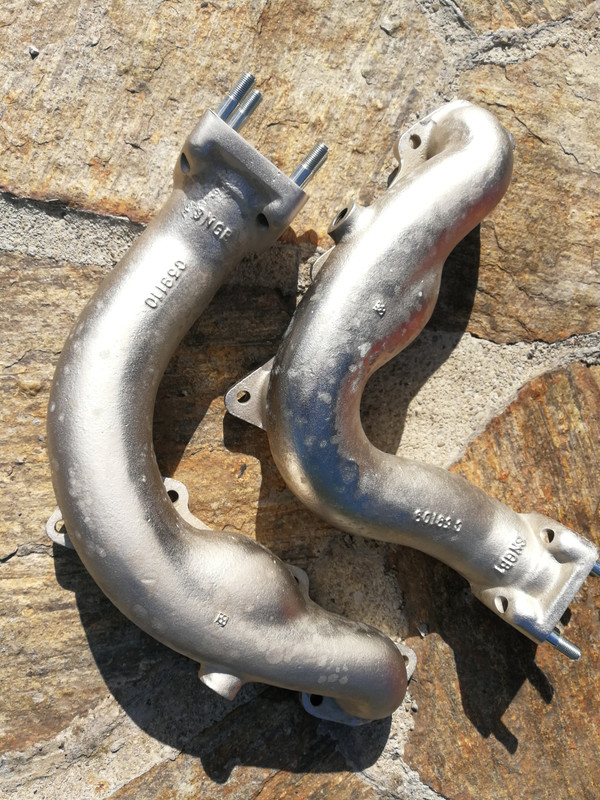

Btw this is how Nickle plating looks like on my exhaust manifolds. Disregarding the price I think this might be the better choice to Zinc plating.
BR, Tom
Edit: As the surface of the manifolds was not very smooth they electro galvanically plated copper first and nickel on top after another company tried to directly nickel plate the iron and failed where it was not smooth.
Hello Tom,
Are you referring to Electroless, or Electro nickel plating?
myJagV12
Posts: 72
Joined: Mon Oct 07, 2019 4:30 pm
Austria
#17 Re: Restoration finish of suspension wishbones
Post by myJagV12 » Tue Mar 30, 2021 9:10 pm
Hi Bill !
They were doing electro plating on the exhaust manifolds.
I think this would also be fine for the suspension parts ?
It was (finally) done in a small local shop.
BR, Tom

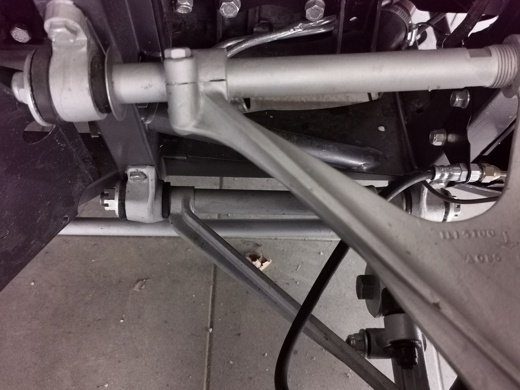

I finally got to zinc plate the near side front suspension parts.
On to the offside parts soon.
Can post recipe if anyone's interested.
Hope it lasts.. if it doesn't then will paint .
Colin
