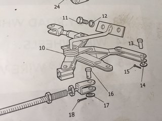

Just had my '71 OTS MoT'd... It passed, but with a note "Nearside handbrake effort very low! Needs looking at".
Which part of the mechanism do I need to adjust to fix this? And can I get at this from the rear axle access points underneath the rear shelf?

The problem is that the handbrake mechanism pulls each side unevenly and maxes out before both sides are adequately pulled in.
There are two fixes:-
1/ You need to to pull A closer to B before the handbrake cable adjustment runs out. This can be done by drilling a second hole for the clevis pin and using that instead of the one in the end of the handbrake cable.
2\ Do the Dave Kerr mod. This makes the whole mechanism "float", so no uneven pull is possible. It's a very neat fix but requires you pull the handbrake mechanism out to do the mod.

I've just put the IRS back in the car and I suspect I rushed reassembly of the handbrake mechanism.
MarekH, the adjuster is at maximum stretch, any further and it'll fall out of the block it screws into. I think I need to adjust the thread on the yoke that links to the right side handbrake.
Steve, the pads were in good nick when they went back into the car, I don't think they'd easily disintegrate so I think the adjustment is the solution.
I'm hoping to get at the mechanism through the brake bleeding hatches rather than having to drop the IRS again.
