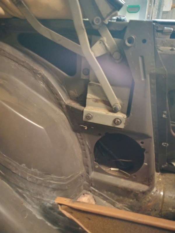

My car had fibreglass wadding in the rear wheel arches and inside the bulkhead.
I'd removed mine also, I'd always thought it was just some pathetic effort to make the speakers sound less tinny ...
So the boot does extend over the rear haunches to the the cockpit and there are 3 openings into the cockpit (on both sides).
The openings for the speakers are closed by the speakers, the other openings would have been "closed" by the fibreglass wadding, i.e. the triangular openings above the rear wheel arch and the smaller unseen openings that are covered but not sealed by the hood frame mounting plate, maybe these can be sealed by duct tape more effectively than fibreglass wadding, if other boot sealing efforts aren't effective? Then, if the problem persists, maybe time to do something about the unburnt hydrocarbons being sprayed out of the exhaust pipe, i think it is the wet exhaust that is mostly the cuplrit? This is almost entirely the reason I am upgrading to latest tech fuel injection, to completely solve this fumes stench issue.

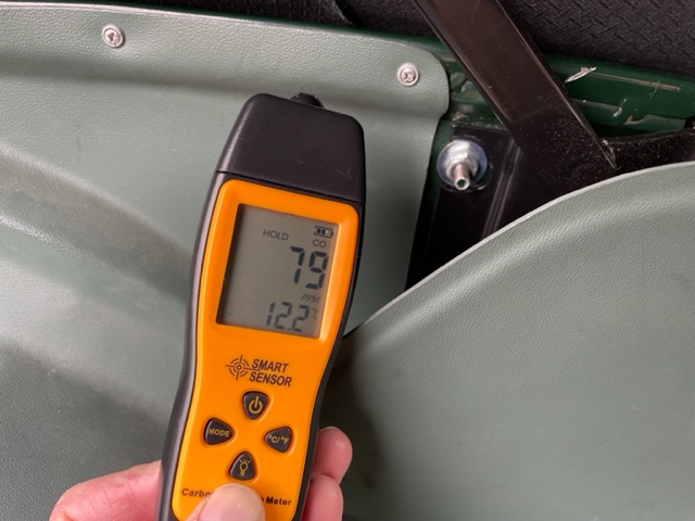

Thank you Colin for your input. I have not yet obtained a smoke machine but I have purchased a carbon monoxide meter and discovered some startling and intriguing results!
From a cold start general levels reached over 60ppm. Once warmed up and with the windows closed inside the cabin the levels are 10-15 ppm. If one window is half opened this raises to 25-30ppm, if both windows it's around 20-25ppm. However, with window(s) half open and decelerating this can massively increase to over 60ppm. Moving the meter around the interior makes little difference, but following Colin’s post I stuck it in behind the covers above the front of the wheel arches and bingo! The readings increased considerably.
Now for the really interesting bit. I shut the meter in the boot and it read 45ppm with windows closed and 20ppm with windows open. I know the boot seal is poor so I masked it off with the meter in the boot – it recorded 100ppm!
So it would appear the poor boot seal is actually letting the gases escape?!!
With the boot seal masked the readings inside the car above the wheel arches reached a maximum of 86ppm. Bearing in mind after all the work already done to cure the fumes and the fact that it is now perhaps 50% better than originally, I can’t imagine what the earlier readings would have been. No wonder I suffered from red eyes and headaches!

Whilst most garages either told me "they all smell so just get over it" or concentrated their investigations on leaks from the engine compartment I remained steadfast that the level of fumes was not normal and that they were drawn from the rear. Despite assurances from the restorers that the rear was entirely sealed it certainly proved not to be the case. There were holes everywhere!
I conducted my measurements using a carbon monoxide meter which has proved to be exceptionally useful. The holes were too numerous to list but the rear lights were very poorly fitted and probably one of the major culprits. The fumes leaked into the boot to be transferred through the inner arches (and other gaps) into the cabin.
