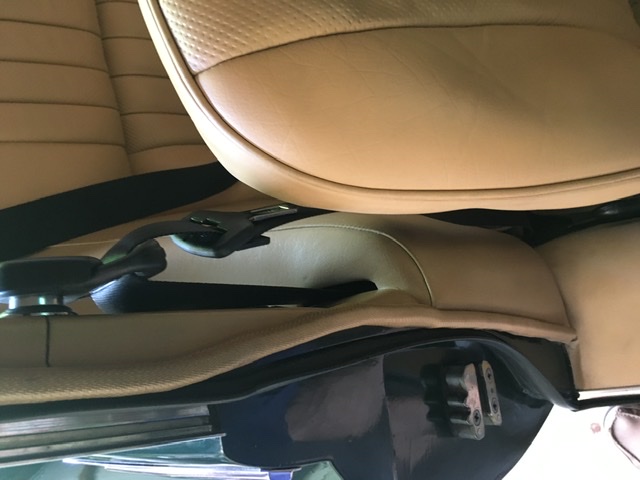

#6 Re: Inertia Reel Seatbelts 2+2
Thanks for the photo, looks like there is plenty of space with the reel facing outward. May need a bracket though to make it fit.

#7 Re: Inertia Reel Seatbelts 2+2
Hello Marcus,
I've attached some photos of the set up in my 72 S3 2+2 for reference. It appears to be original. As far as rego in QLD send me your details, I may be able help having recently been down this path with a US import S3...
