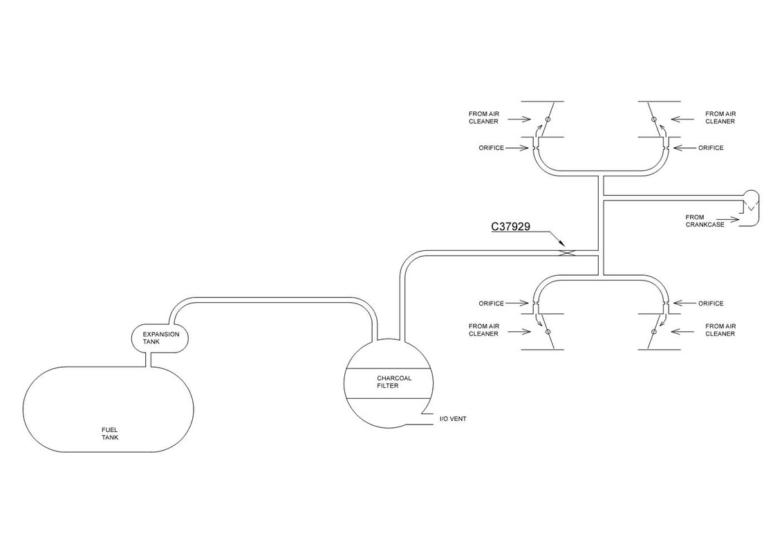

Mine is/was same, ’72 US spec. I don’t have the tan manual (how to get it?) but I’ve studied the system, imo its pretty good, simple and effective. Here is how I think it works:
Crankcase ventilation is suction only, removing fumes that blow by the piston rings. I.e. there is no fresh air inlet to the crankcase. Suction is from the carburettors, upstream of the throttle plates. I.e. it is not manifold vacuum, it’s barely below atmospheric. I.e. the system does not compromise your manifold vacuum (as I once thought).
Fumes from the crankcase are sucked into the carburettors, I guess not much when the throttles are closed (idling), but not much blow-by then either.
The “metering devices” that you refer to, shown on the diag. as “orifices”, I’ve always imagined that these are how the system was crudely calibrated/balanced so that flow was not all through one carb.
The same system is used to purge the charcoal canister. The I/O vent lets air in and out as the fuel level rises and falls or expands/contracts, the fuel is trapped by the charcoal. When the engine is running, air that is drawn into the I/O vent and through the charcoal by the carburettor suction effectively cleans the charcoal, transporting the trapped fuel into the carburettors.
Also shown on the diagram is the C37929 “vent valve”. My assumption is, this is set to restrict the rate of air that is drawn into charcoal canister (I/O vent) by the carbs, as necessary to ensure that there will always be positive ventilation of the crankcase.

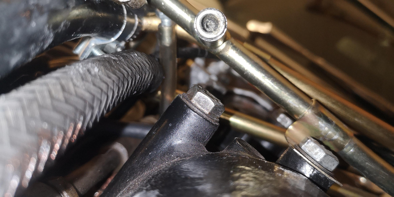

I had to disassemble the pipes connecting the carburetors to the crankcase ventilation. There are no ' orifices´or ´metering devices´ as one would expected, the whole pipe from crankcase to the Strombergs is about 8 mm internal diameter.
On the A bank, the rubber elbow connectors to the carburetors had a 5 mm hole venting the carburetor to the atmosphere. The upper part, to the crankcase metal pipe, was blocked by a ball from a bearing. Only on the right side.Courtesy of a previous owner, as rightly suggested by Marek. Purpose unknown.

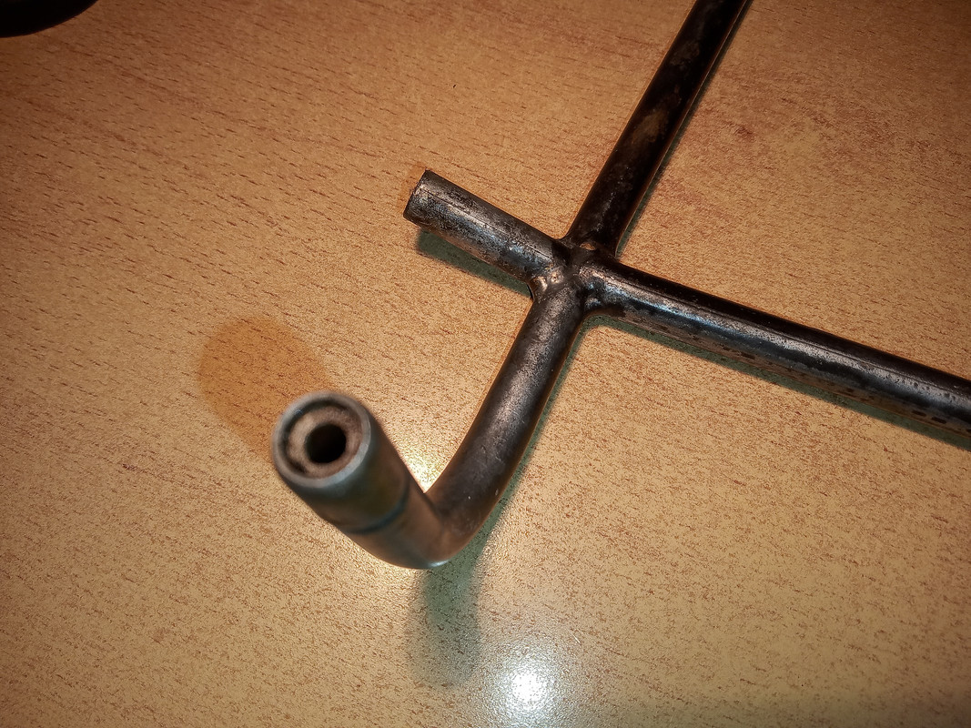

#9 Re: series 3 pcv questions
Here is photo of one of the orifices I was referring to. Orifice diameter is 3.7 mm.

Colin, mystery solved, many thanks for your photo: I just come form the garage and disassembled the metal pipe to the carburetor elbows and the restrictors are there. i did not see them before because i expected the orifices to be quite smaller.

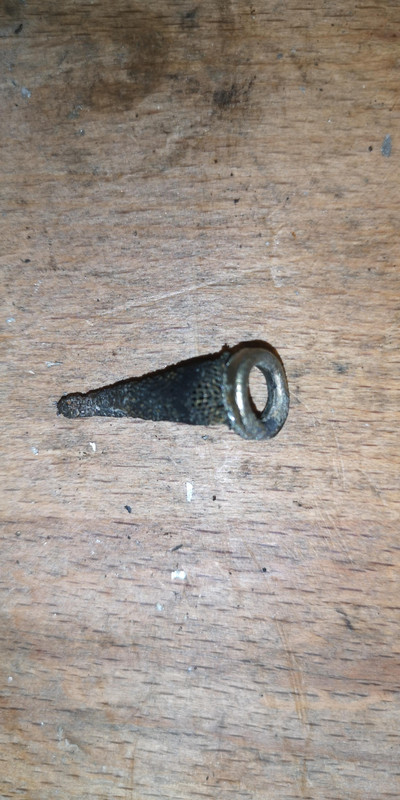

One last curiosity: On the pipe connecting to canister I had the filter C13457 for the earlier models instead of the C37929 restrictor (?) which is not available any longer (photo catalogue parts) C13457 still shows in SNG as Conical Brass oil gallery Filter serving Hydraulic tensioner (!!!).

Above , with the small clogged filter still in place
