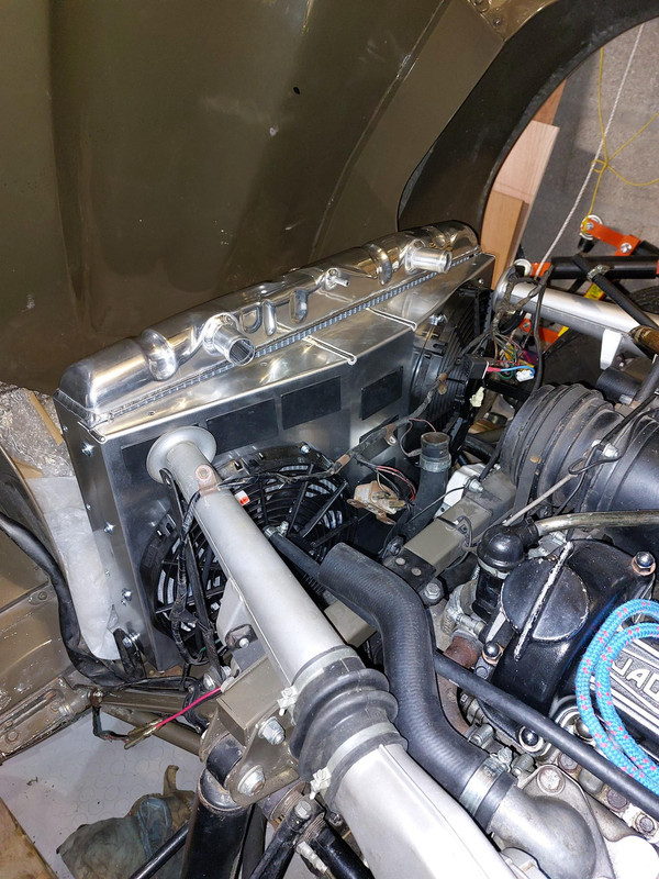

I don’t have exactly the car/situation you describe, but here’s my experience. I bought an Auto S3, which was missing the radiator. I waited and sure enough, found a manual gearbox (5 Speed) so I bought a new, aluminium radiator for the car, manual version without the Transmission cooler. It was from NAR, quite a few years ago, bought at one of the Stoneleigh shows and was a little cheaper being a scratched example. I bought modern fans from V12S in the USA, my original shroud was probably still attached to the missing original radiator. A year or two later, still having never started the car, I emigrated to Australia, bringing the car with me. When I finally fitted everything, I used a modern copy of the Lucas relay, which immediately fused closed. I then re-wired, I think the wiring diagram I used is in the knowledge base still. The new wiring used two Bosch relays, one for each fan and I added a modern blade type fuse.
The car has since run, in traffic, at ambient temperatures over 40 degrees C with no problems at all, but a proviso is that the engine was also cleaned externally and internally and that certainly helps as there is no silt in the engine, something the V12 is prone to if neglected. Ten years on and I changed the coolant, which was as clean as the day it as installed, though the car is low mileage since rebuild.
Unfortunately V12S is no longer active as far as I can see, but the aluminium shroud is relatively simple and the fans are just the largest that fit. The only problem I have had other than the relay, is that the aluminium drain plug stripped a thread when I changed the coolant, requiring a new, stainless steel plug with a helicoil insert, probably a good upgrade in any case.
