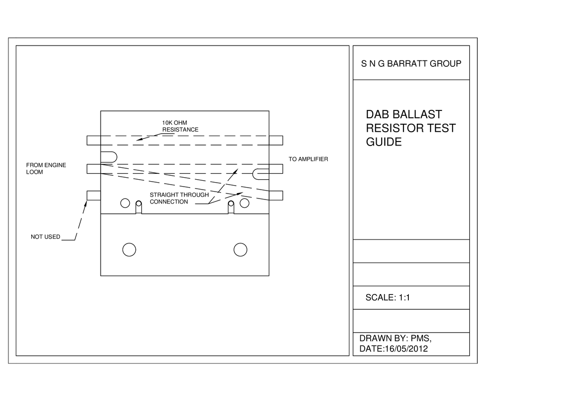

I have had the same questions and got this schematic for the SNG ballast resistor. The original system used the ballast resistors to get a stronger spark during cranking. I guess the spark is now always strong, so that is not needed anymore.
I am not fitting this new ballast resistor anymore. Just a simple 10k resistor to the tach will do. One could also replace the double starter relay with a standard SPST relay. It is all just preferences. I like to keep things simple, but I know it can be more confusing for future owners to deviate from standard.
