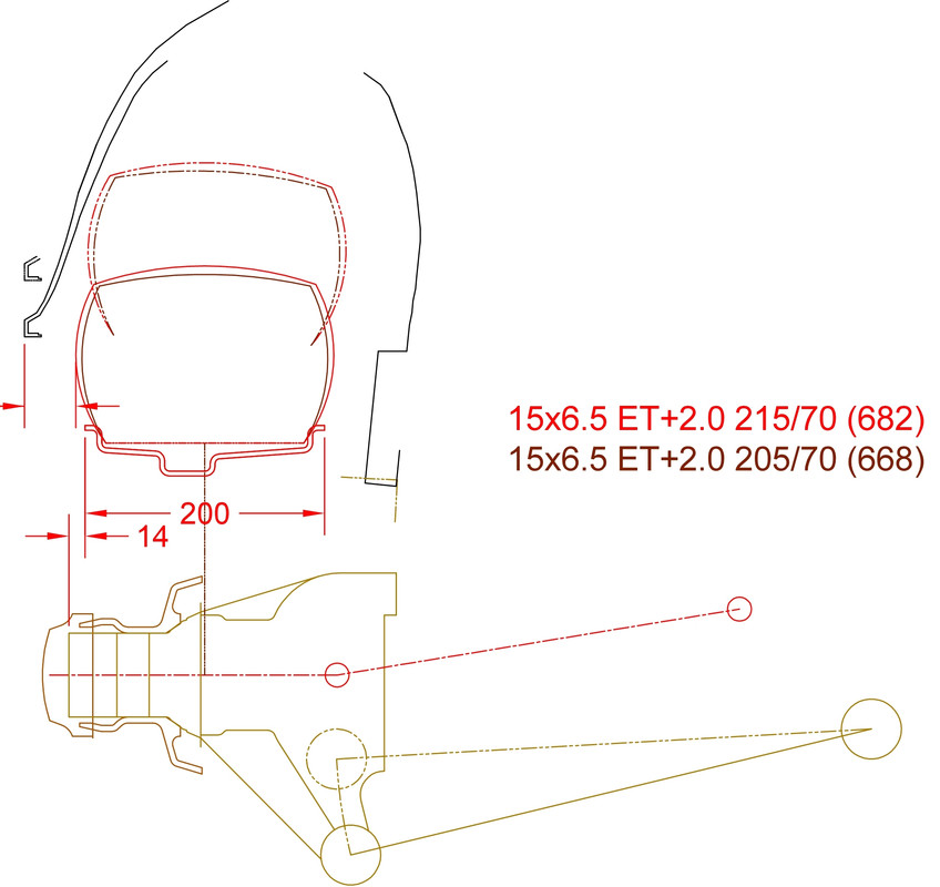

Yes, that is correct, the usual "off-the-shelf" 6.5x15 wheels may rub on the rear fenders, if you hit a big bump, with any sort of load in the boot. This graphic (from viewtopic.php?f=9&t=19914&p=162155#p162155) illustrates the issue. The tyre positions are: no suspension travel, full suspension travel (to the bump stop):
This issue is NOT due to the width of the rim. It is because the wheel "offset" (horizontal distance from the mounting face of the wheel hub to the middle of the rim) is different.
Oem S3 wheels (6x15) have +20 mm offset, meaning the middle of the rim is 20 mm inboard of the face of the wheel hub.
The "off-the-shelf" 6.5x15 wheels that are touted as upgrades have only +2 mm offset, i.e. the rims are 18 mm outboard relative to the oem, this is why they can rub on the rear fenders. If these wider wheels had the oem (+20 mm) offset they wouldn't rub. In fact, if the oem offset is retained even wider (7") wheels can be fitted without any modifications or compromises whatsoever.
Sometimes wider wheels are to achieve a "dished wheel" appearance; not possible with e-types due to the centre hubs always protruding outboard further than the rim.
Changing wheel offset (from oem) has other negative consequences. Imagine a straight line through the front ball joints to a point on the ground, the distance from this point to the middle of the tyre on the ground is called the "scrub radius". If this is zero the wheel (tyre) would steer/rotate about a single point. When it is not zero (+ve or -ve) the tyre cannot steer/rotate cleanly, it must also drag/scrape (scrub) sideways. Some scrub radius is beneficial, too much is not. Changing the wheel offset directly alters the scrub radius, effects the steering effort required, tyre wear rates and directional stability during steering and braking. So it is always best if the wheel offset (therefore scrub radius) is kept as per the oem design.
Ideal for S3 e-type is as also shown in the earlier post referenced above, i.e. 7x17 ET+20 with 215/55 tyres.
Imo these ones: https://www.imagewheels.co.uk/db3-alloy-wheel/

I see in your picture that you assume that the camber of the wheel remains the same (wheel remaining vertical) during the rotation of the suspension arm, hence the rubbing of the tyre on the outside fender.
Should we not consider that the camber becomes negative in such a situation, hence bringing the top of the tyre more inside the fender during the compression?
Serge

Thanks Serge, yes I should have, I measure 3 degrees. Previous posts edited and graphics corrected, now doesn't look so bad ...
Tyres also make a difference of course, 205/70 are oem so speedo not effected and the the spare fits properly in the wheel well.

Your drawings give a good idea of what may happen when modifying the tyre width/profile and the rim offset.
In particular the comparison of 15x6 ET20 205/70 with 15x6.5 ET2 205/70 (in your other thread, shown here under) is useful to visualise the nearing of the fender under compression:
Incidentally did you just guess the profile of the fender and its position relating to the axle or is it a rather accurate drawing?
I am contemplating the fitment of 5.5 x 15 Borrani rims on my S1, offset measured ET 22 in place of the standard wheels 5.0 x 15 which have an offset of ET 33.
This means that, keeping 185 R15 tyres, the top edge of the tyre will be closer to the fender by about 1 cm, which remains limited.
I assume that it will still be OK.

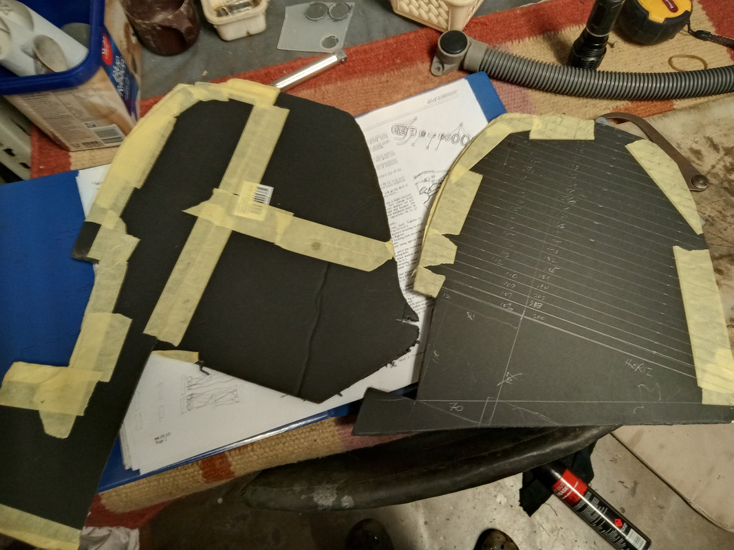

To get accurate fender profile I made cardboard templates, 1st one in sections taped together and into the fender; used this to as pattern for a one piece temple on which I drew equispaced parallel lines that I could measure and use to make cad dwg.
Hubs likewise accurately drawn and positioned. So that I could also check for adequate installation clearance. Reduced offset (rims closer to the fenders), wider rims, fatter (therefore taller) tyres will all reduce installation clearance.
Note on my dwgs there is a 2nd representation of the edge of the wheel arch, this shows the relative heights of the fender arch and the wheel hub when the car is jacked up and the hub is fully lowered, you can see that for S3 you can just about push an original wheel (668 mm rolling dia.) on directly, no necessity to tilt, lift and straighten inside the arch.

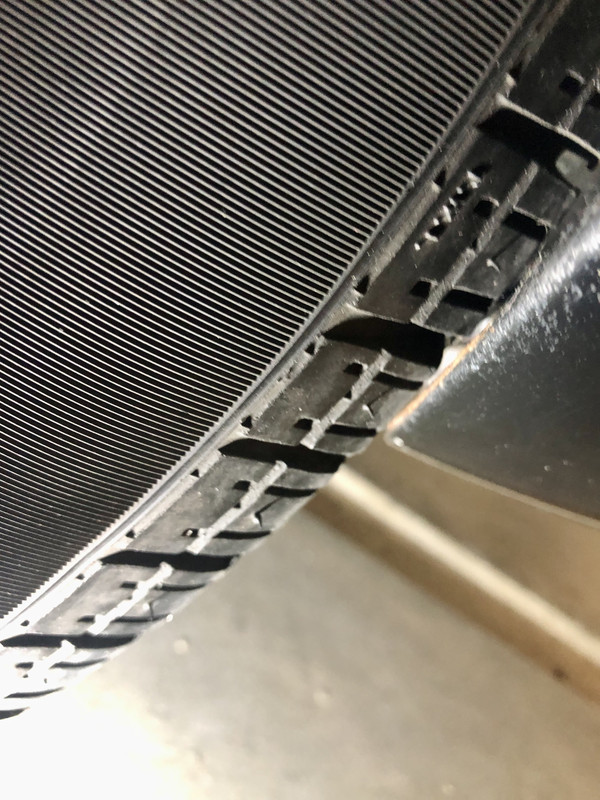

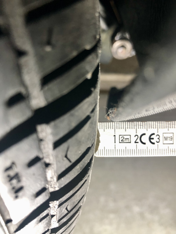

yes I have on my Series 3 Coupe the Dunlop (MWS) wire wheels 6 1/2 x 15" with 215/70VR15 tires (Pirelli P4000 Super Touring)
So far no issues with the clearance, even when the car is fully packed with four passengers, but yes it is very tight also at the front axle (Have some scratches in the front inner housing of the hood, only on the right side) but it only happens by steering in low speed e.g. getting into a parking lot.
Btw ordered the same size now as an alloy wheel (unfortunately did not arrived yet) to give you some feedback
Hope that helps.
