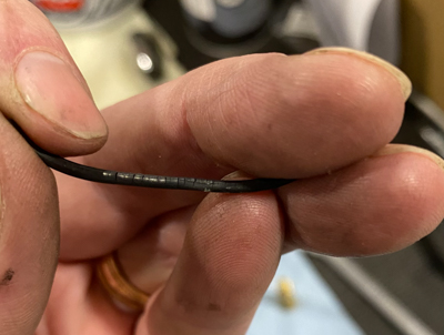

Just an idea, as I had a similar situation with a tuned 4.2 running SUs.
The carbs had been rebuilt, however the engine would not rev up easliy. It was fine at idle though.
I spent ages making adjustments to the timing and air screws etc. No difference.
The solution took a few minutes when I had figured it out. It was not getting enough fuel.
I took out the needles, laid them on a flat surface then filed a flat on each needle. About three strokes of a hand file on each one.
That increased the orifice just enough to increase the fueling and gave an engine that ran very well.
I bought a set of proper richer needles, but it did not run as well as the filed needles, so back in they went.

I am driving a EV12 with a 6,0L motor from an XJ81 and have 20 years of experince with carb-tuning and needle shaping. The car has now 4 originial EV12 Stromberg carbs and 4 taylor-made needles.
The correct AFR for idle is 12.5 to 14:1.
The correct AFR for light cruise can be AFR 15 - 17: 1. I am driving the He-Motor sometimes with 18:1 up to 19:1. Absolutely NO problems since 15 years. NEVER , never a piston can failure, if the mixture is very weak at cruising. IF the pedal is pressed to the flow when accelerating or nearby full throttle, the mixture for acceleration and high speed shall be at AFR 13 to AFR 14. If you drive with AFR 13,4:1, 10% of the gas leaves the motor unburned. But the motor needs the too much gas for inner cooling at high loads.
I say it again: I am driving my motor sometimes with plugs white as snow at part throttle. NEVER had any problems with heat problems. I have mounted a lambda-meter in the car and can see just-in-time , how the mixture of one bank is. At part throttle the total amount of heat is MUCH to small to kill a valve or a piston.
Back to your real problem:
1. You shall adjust the 4 needles at idle to a AFR of roundabout 13 to 14.
2. You have to grind some material off the 4 needles, that they will be thinner and therefor the mixture less weak in a CERTAIN area of the needle. I think you shall reduce the diameter of the 4 needles by 2/100mm in an area roundabout 6 – 12 mm above the piston. You start with 1/100mm, go up to 2/100mm and reduce again the 1/100.
3. Then you mount the needles and make a test drive, checking how the AFR is now. If the AFR-meter shows still a too weak mixture, you can continue to grind off material. Only in small steps. Otherwise you will ruin the needles and the mixture will become too fat. If your car is cruising with a weak mixture, the amount of bad smell inside a roadster will by low(er).
Grinding 4 needles, that the Lambda is correct in any load, is very difficult. You need some experience and a Lambda-meter to do this succesfully.
Avoid to grind the area of 3 – 5 mm above the piston. I have reduced one time 4 needles by 3/100 mm, between 3 and 7 mm above the piston. The colour of the plugs did a VERY big jump from very bright gray to daaaark velvet black. In this low area the mixture is very sensitive to a small different needle diameter. I had to throw these 4 needles in the garbage and start to grind 4 new needles to the shape, they had bevor my last grinding. I am writing all the numbers allways in a tabella, that I am able to see and comparte, what I am doing.
You need something to measure such small differences in the diameter of the needle.
Grinding is very easy. I have done it with sanding paper by hand. Lot of work and bad results. The needles will become never round.
Later I put the needles in a small accumulator drilling machine and put the sanding paper between two finger-tops round the needle. If the drilling machine is turning it makes a perfect round needle. I used in steps 400, 800 and 2000er paper for this. The last finish I did with a piece of 2000er paper, which I use since 20 years for polishing.
I told you my estimate how much you have to change the shape of your 4 needles. Maybe you can find and buy 4 needles, which are very similar to this.
If the mixture still is weak at cruising, maybe (?) you have to grind the needle also up to 15 mm above the piston or another 1/100 m betwwen 6 and 12 mm.
Needle shaping is a lot of trial and error, IF you wand a good result. Grinding away more off the needle, that the mixture at part throttle would be below AFR 14,7, will result in good drivability, but higher gas consumption and bad smell.
The goal will be allways a weak mixture at part throttle. Making the mixture fat, would be the easy way of ‚adjusting‘ the mixture of 4 carbs.
A bought needle will NEVER be as exact as 4 well himself ‚done’ needles. You need some intelligence, few ‚tools‘ and two days, to get a very good result.

"I'm not confident in my abilities to get exactly the right amount of material removed, in the right place, 4 times for each needle. I'd feel much more comfortable buying needles that are close, even if they are not perfect. Close is good enough in this case."
You are right. SU or Burlen offers different needles. I think there is a little DOS-programm for the computer, to compare the different needles of SU carbs. With this information and little calculating, you should be able, to chose a 'good' solution.
The only problem is to know, at which position the piston in the carb is, if you drive in the 'area' , where your mixture seems to be too weak. I also have never checked, how high the piston is, when I am driving with 50, 60 , 70 or 80 mph. This you must know, that you can identify the area of the needle, which is not correct.
For the first step I would change the shape of the existing for needles a little bit less thick. Start with a reduction of 2/100mm in this area, mount the needles, make a test drive and check the AFR-gauge. If you reduce 1/10mm this is toooooo much.
I have reduced the diameter of the needles between 4 und 8 mm high above the piston (low part throttle) with 3/100mm, because of poor running and a too weak mixtur. The colour of the spark electrode 'jumped' from bright grey to darker than deeeep black. The electrode looked like black velvet. I hade to throw the needles in the garbage, bought new shape top the previous dimension and rediced 1/100mm. This was enought for 'good' running. The mixture was still weak with AFR roundabout 17,5, but not too weak with less than 19:1. The 6,0L HE-motor is running well also with a weaker mixture, a pre-He would have problems.
If your needle-shaping would not be succesful, you can try with new needles. I would prefere 'taylor made'.
Most important is to shape very few material with care. Test in the car and shape again with care.

To round this out, I never heard back from Burlen, but I spent much time analyzing needle profiles and decided on the BDW needle. The BDW is basically perfect, except that it was still rich at idle. Off idle beyond about 1300 rpm the mixture was exactly where I'd want it.
To compensate, I basically did the opposite of what Wolfgang suggested above. Instead of removing metal, I added it. I added about 0.002" of solder to the top of the needle only in the idle range, and only on one side. As it's a biased needle, I put the metal I added in the part where the needle doesn't touch the jet. It took a few tries with the soldering iron and a file to get the amount just right, but I was patient and got there in the end
The car runs much better now, the idle is clean and the AFR are slightly rich at cruise and it enriches under heavy throttle. The car behaves as it should now. It also takes much longer for the CO detector to go off in the shop now, whereas previously when the car was started it would go off after about 30 seconds of running. For comparison, a modern car can idle for 20 min inside the shop without the detector going off.
