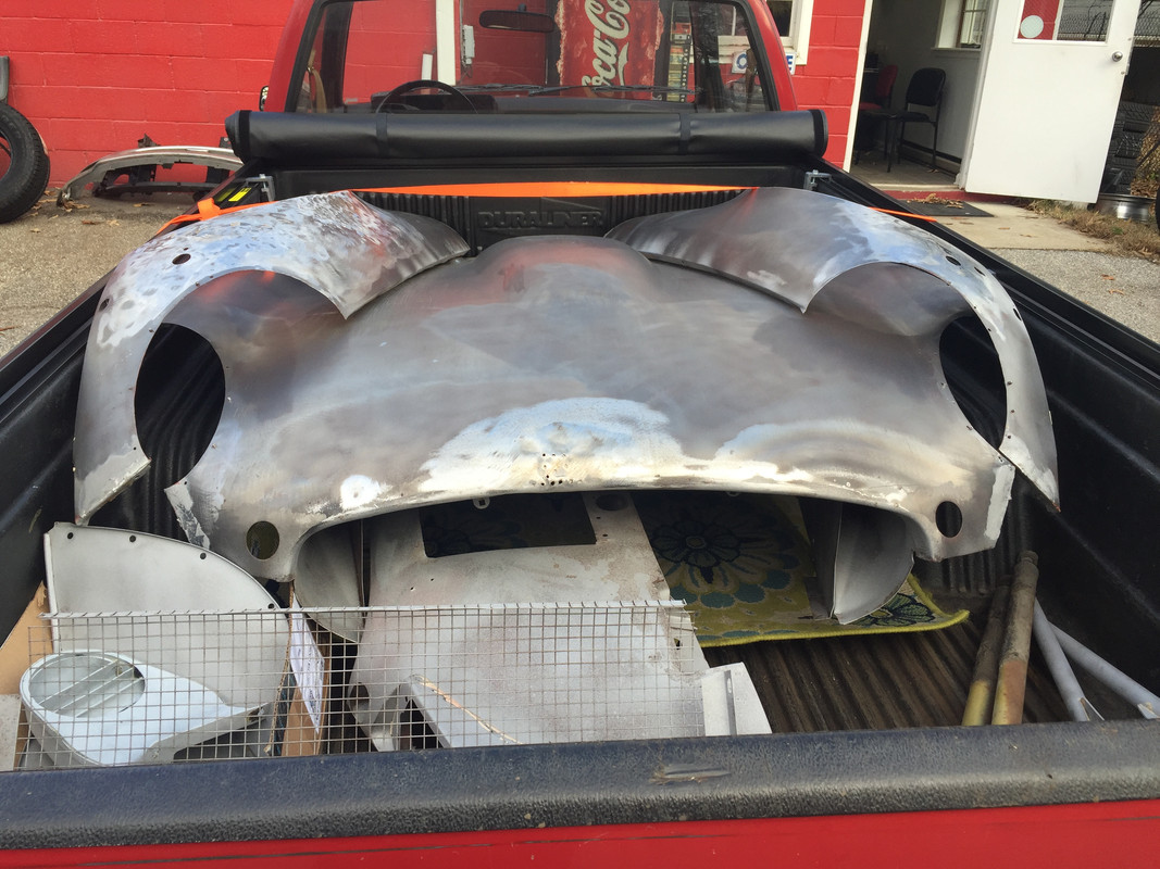

The whole process of commercial car body paint removal is one best avoided if possible.
Use poly discs on an angle grinder. Be kind to your car.
https://www.ebay.co.uk/itm/5Pcs-4-Poly- ... OSwUvldEnZ~
I have seen expensive disasters with shot blasting, media blasting, stripping and dipping.
Moving bare shells is dangerous.
Leaving cars at commercial premises in a queue to be processed is dangerous. "see you in 6 weeks".
Picking bare shells up with a lift truck is often dangerous.
Its all expensive too!
You must wear a full face helmet and welding gloves when using stripping discs. Do it at home outside in your own time.
Stripping discs are very effective, cheap, no metal sparks, doesn't heat or scratch the metal. Very fast too, do it at home.
Not good on underseal, this really needs heat and a scraper.
I have stripped the paint down to bare metal on whole cars for a few pounds.
Even my local shot blasting company recommends them.
Dont worry about rust inside areas you cannot get to. You will wax inject the box sections and the back of the welded areas after the painting and assembly.
If rust hasn't come through 1.2mm sheet steel in 50 years, it isnt going to.
Watch edges though.
Here is one i did earlier.
