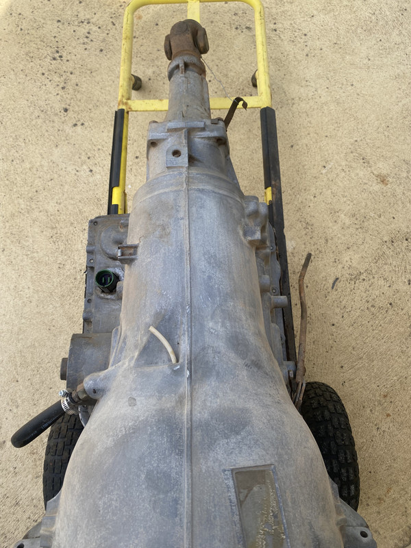

I have measured up a 4L60E transmission with a view to replacing my BW 3 speed. There are two main problems. One is that the 4L60 oil pan is not central to the casing and would foul the bodywork and second the transmission tunnel is tapered towards the rear and again would foul the oil pan. Without cutting the body the 4L60 is not a viable alternative.

Big T-Rev wrote:
Mon Feb 19, 2024 3:11 am
I suspected as much, thanks.
