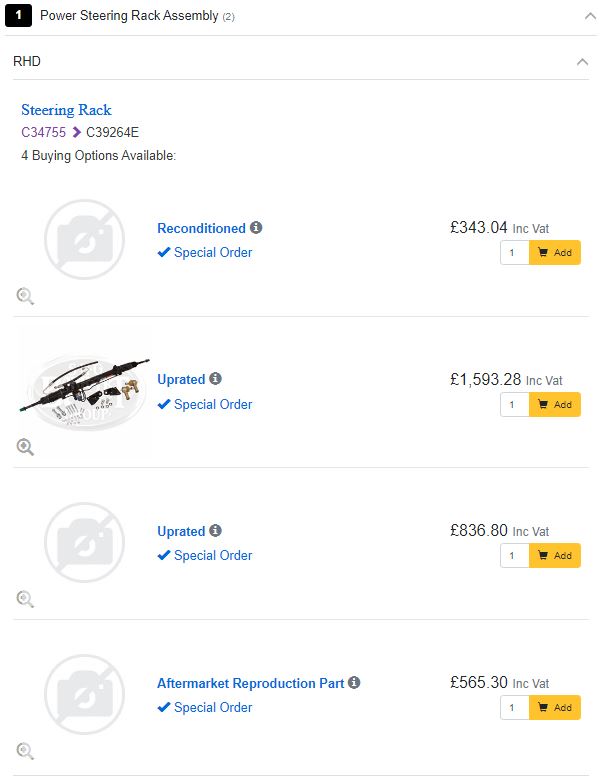

IIRC there was a problem with sourcing RHD power steering racks for the S3, although SNGB seem to offer them as a special order part.

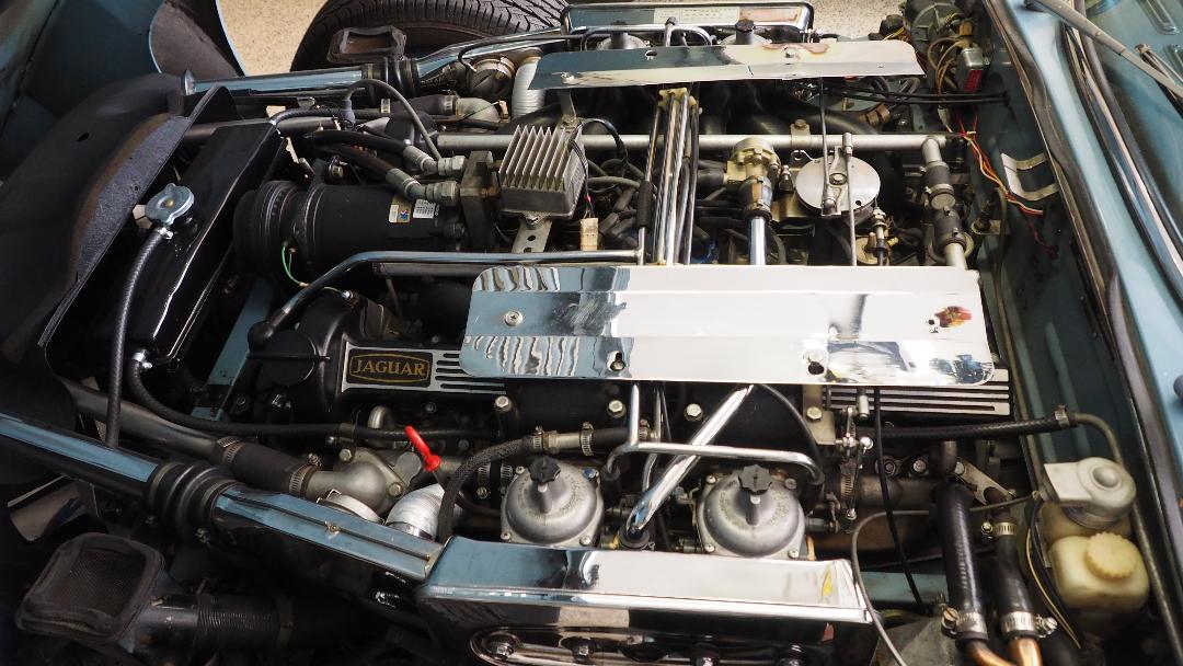

#8 Re: Series3 LHD to RHD conversion - DIY task?
A different view of the engine bay. Concours judges and experts please advise on all problems and errors....
