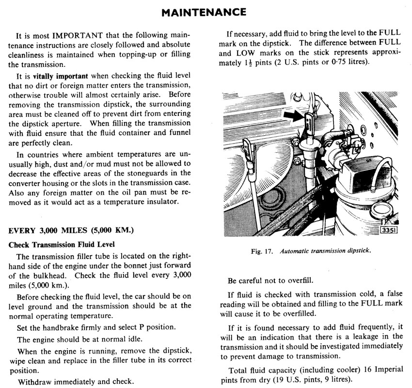

#8 Re: Automatic transmission V12 2)2
Suck it out of the dip stick tube...syringe and tube...Steve
#9 Re: Automatic transmission V12 2)2
Gents,
still looking and appreciating your advice on ATF.
The strange things is I siphoned out extra ATF but still couldn’t figure out the real fluid level.
I checked it with cold engine and was above max level.
Then when engine warm and running and hand gear engaged…it was showing NOTHING ( totally empty) on the dip stick ??
As engine cooled level started going up again!
Any ideas ?
A contact in USA sent this below :
"I have a pretty good idea, the fluid is draining out of the torque converter when the engine is off giving you the false impression that you have adequate fluid. You need to check the fluid level right after you shut it down. Funny thing, I did the exact same thing with mine after I bought it 20+ years ago. Thinking that it was leaking because it was over filled, I drained it down to the full mark, well you know the rest of the story- test drive didn’t get out of the driveway till I added the fluid back.
Cheers,
LLynn
PS: My understanding is that the torque converter has a valve that is supposed to prevent it from leaking down but it goes bad over time."

#10 Re: Automatic transmission V12 2)2
See post #4 ref checking level correctly:
viewtopic.php?t=10786#:~:text=Re%3A%20S ... id%20level.
