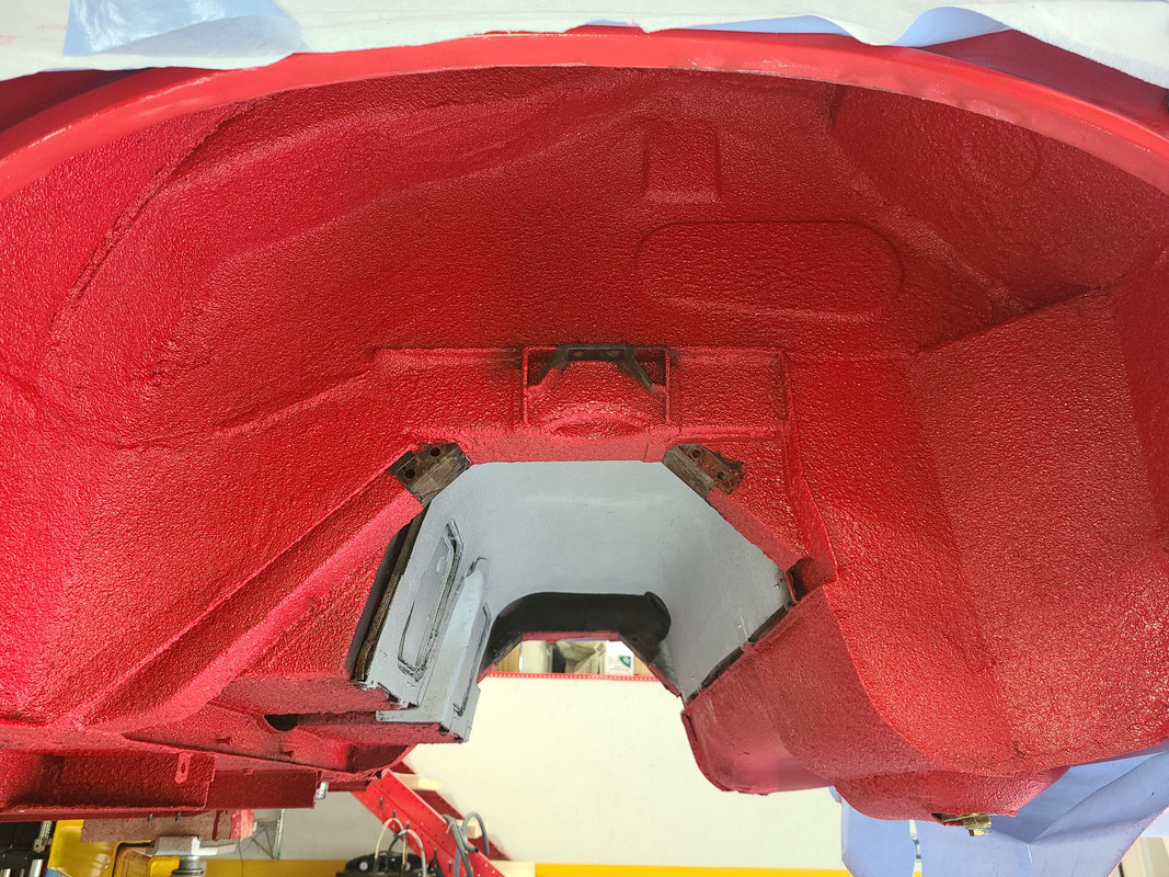

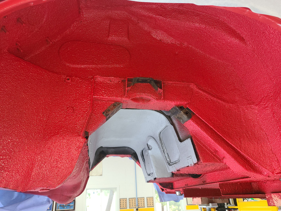

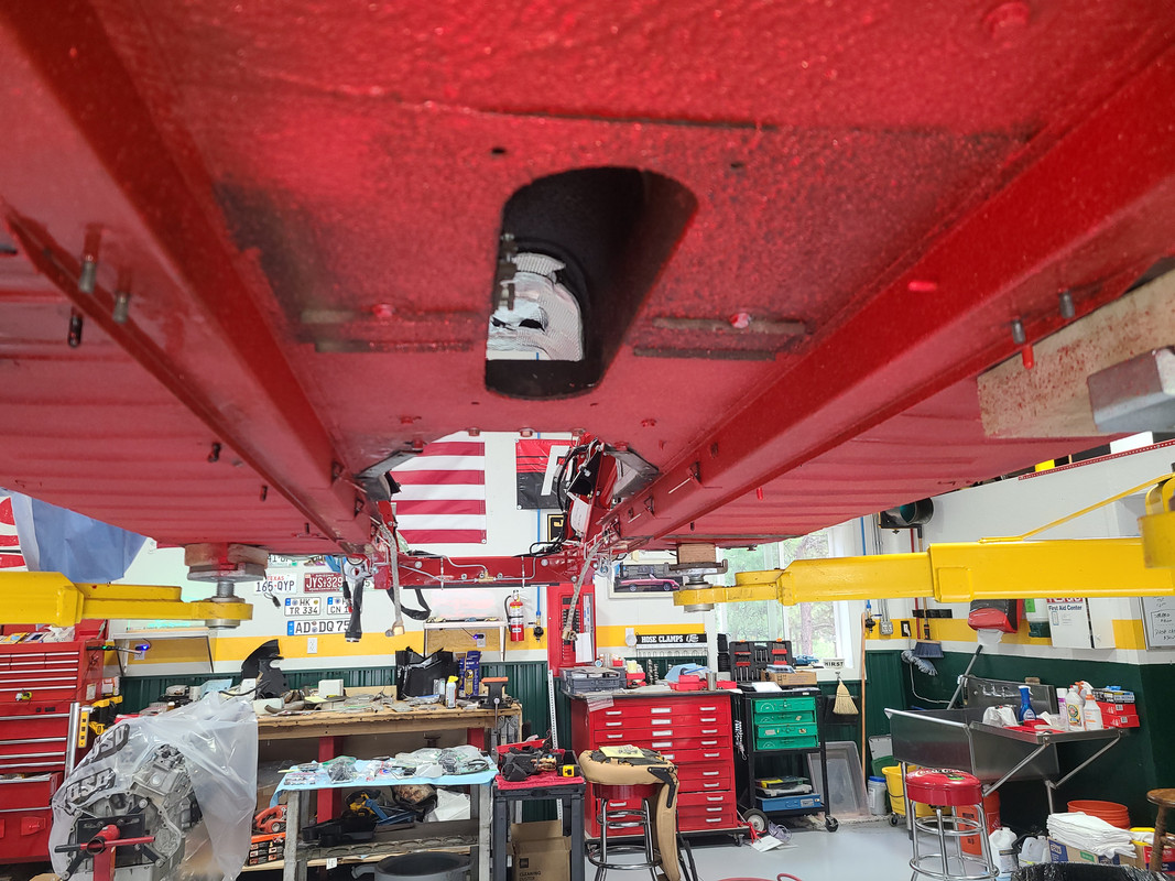

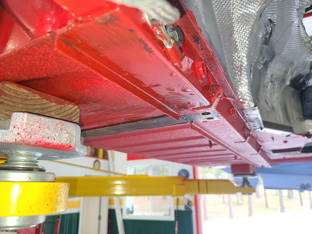

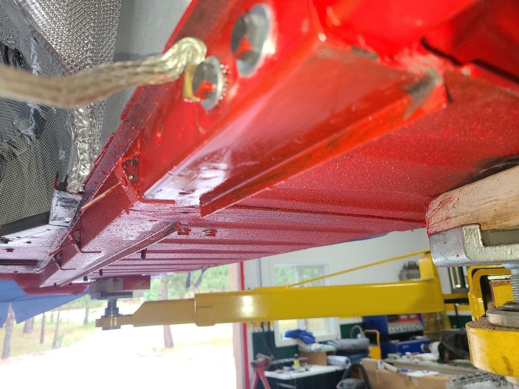

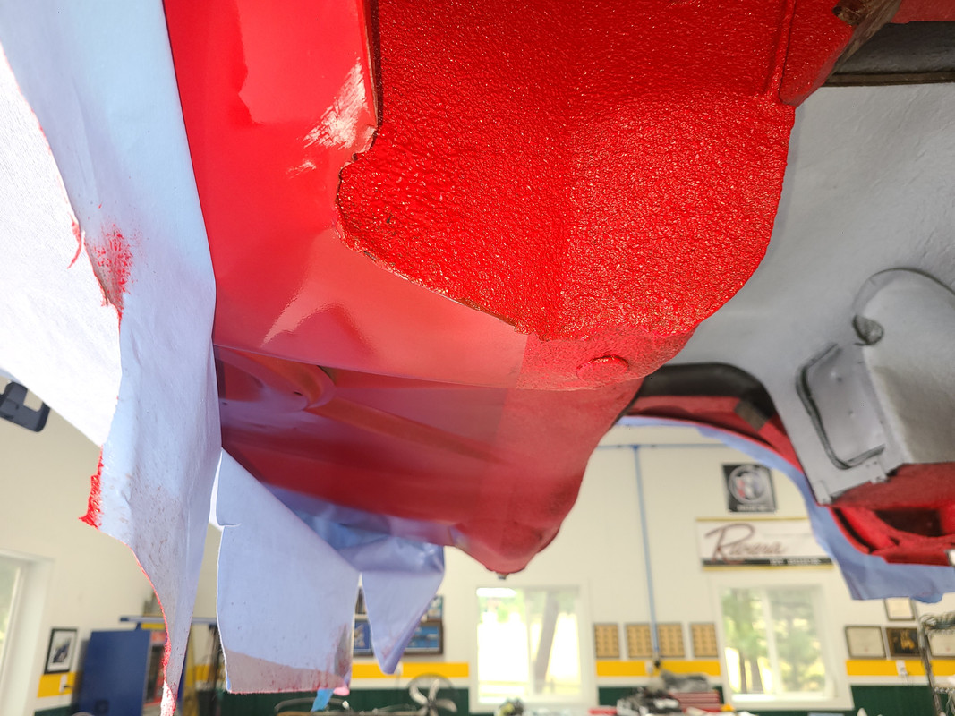

Getting back to the original question, it took me a while to find my notes but this is what my body/paint guy used on the under carriage of my Series III OTS. Sorry for the delay . . .
He uses TCP Global (online) Custom Shop Tintable Bed Liner. You need to have the color code for your paint and have your paint distributor mix up some. No binder like in the base coat; just tint. Three oz per quart of bed liner.
https://tcpglobal.com/pages/custom-coat-bed-liner
Here are a few happy snaps of the finished results:
I masked off the areas that would take the torsion bar reaction brackets and the mounting brackets for the IRS. I wanted a clean smooth surface form those contact points/areas.
