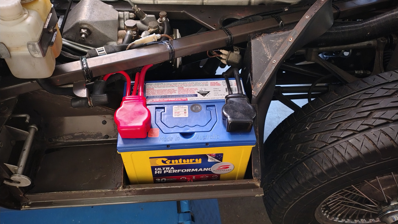

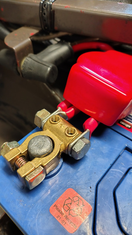

Another way to do it is to run a dedicated starter cable directly from the +ve battery terminal to the starter motor. Then you can go as large as you like. I use 26 mm2. A secondary benefit of this; having a dedicated starter cable that bypasses the distribution terminal means this latter becomes relatively un-cluttered.
Only downside is that the battery terminal lugs need to be changed; to a type that provides for more than one cable to be connected. I also changed the battery, so that the terminal position and access arrangement would be as I wanted:
[Regards,
#5 Re: Starter Motor Cable
Hi Colin....if your going to use a thick cable for the + side then you need to use the same for the - side.....Steve
#6 Re: Starter Motor Cable
Yep. Ground return is also 26 mm2
#7 Re: Starter Motor Cable
Hi Colin..Great....must be an optical illusion your black links thinner than the red....Steve
