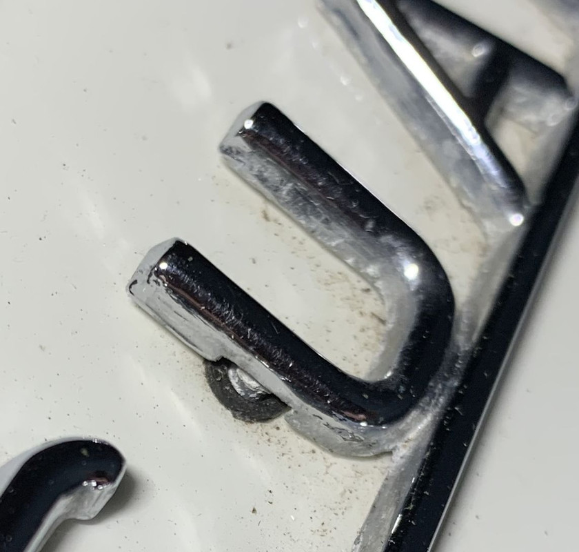

There is a lot of dirt around my rear badges and I would like to remove them in order to properly clean and polish the area. How do I do that? Thanks in advance.

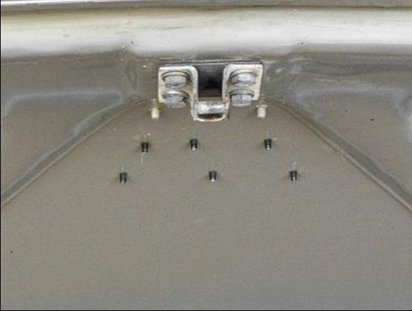

#5 Re: How to remove rear badges?
Post by UK Muppet » Fri Jan 31, 2025 11:43 am
Take/lift the door card off the inside of the door to expose the pins and the ferrules that slide over the pins, then lightly grip the ferrules with pliers and slide them off the pins. I don't mean to be picky but calling the pins or ferrules tangs can be misleading and unless you understand what your dealing with, using a dremel on the ferrule could result in scrapping the badge if you cut through the pin.
The ferrules are BD25659# according to Robeys and they call them a friction bush.
I recently refitted my badges and thought the ferrules pushed into the skin like they did on early Range Rovers but soon realised they just slipped on the pins from behind.
I'm not sure if the position of the badges is the same for S3 as it is for S2 if it is then the lower badge pins may be hidden from view. The 4.2 badge on my S2 is behind the inner framework.
I brushed wax around them on the inside of the door after fitting just to prevent any water ingress.

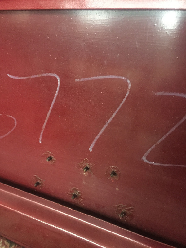

#6 Re: How to remove rear badges?
Post by 18000rpm » Fri Jan 31, 2025 12:33 pm
Thanks for the pic from behind and the part number. It makes much more sense to me now.
Is this part held by friction and I just need to slowly turn and pull it off if I have access from the back? And is it reusable?

#7 Re: How to remove rear badges?
Post by UK Muppet » Fri Jan 31, 2025 1:04 pm
Yes its simply friction and yes just slide them off from the back and yes they can be reused if you don't break them or lose them.

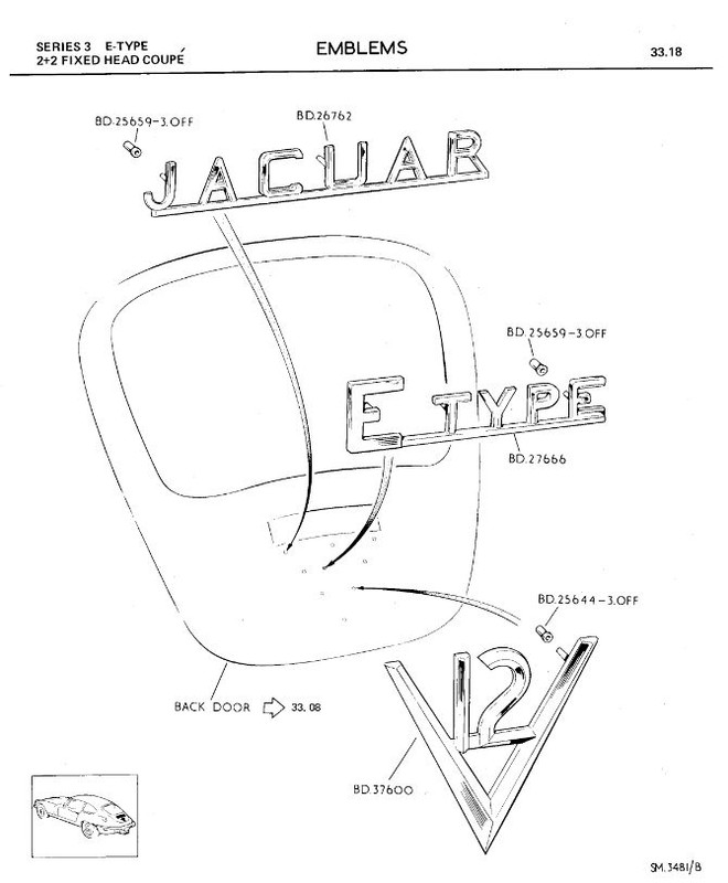

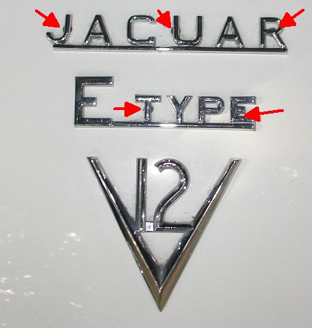

#9 Re: How to remove rear badges?
Post by Bob. » Fri Jan 31, 2025 8:33 pm
Just to add that the S3 PM shows 3off BD25659 each for attaching "Jaguar"and "E Type" and 3off BD25644 for "V12". Jaguar called both "Friction Bush, securing emblem". They are shown fitted with the top hat on the outside of the panel. Some of the top hats are just visible in the second image below. Badges appear to be relieved on the rear to allow the top hats to fit in the recesses.
The same fixings were used on the OTS and can be seen on several low mileage cars such as the one below with the badge pins protruding slightly through the black BD25659 bushes.
Bob
