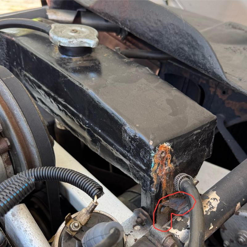

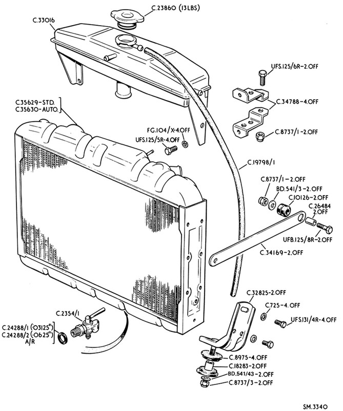

Anyone know what's the part number for the bracket circled in red? I can't find it in the parts diagram.

Do you mean this bracket whch is part of the coolant pipe assembly?

You are absolutely right Bob! Didn't realize it is part of the pipe.
Great thank you! This should be the part:
https://www.sngbarratt.com/English/#/UK ... 6119f49a30

you won't find the bracket alone at the known dealers.
Today only spare parts with attached (welded) brackets are available.
The early V12 have a seperate, screwed bracket (like mine)
So you either find a used part or replace the complete pipes.
