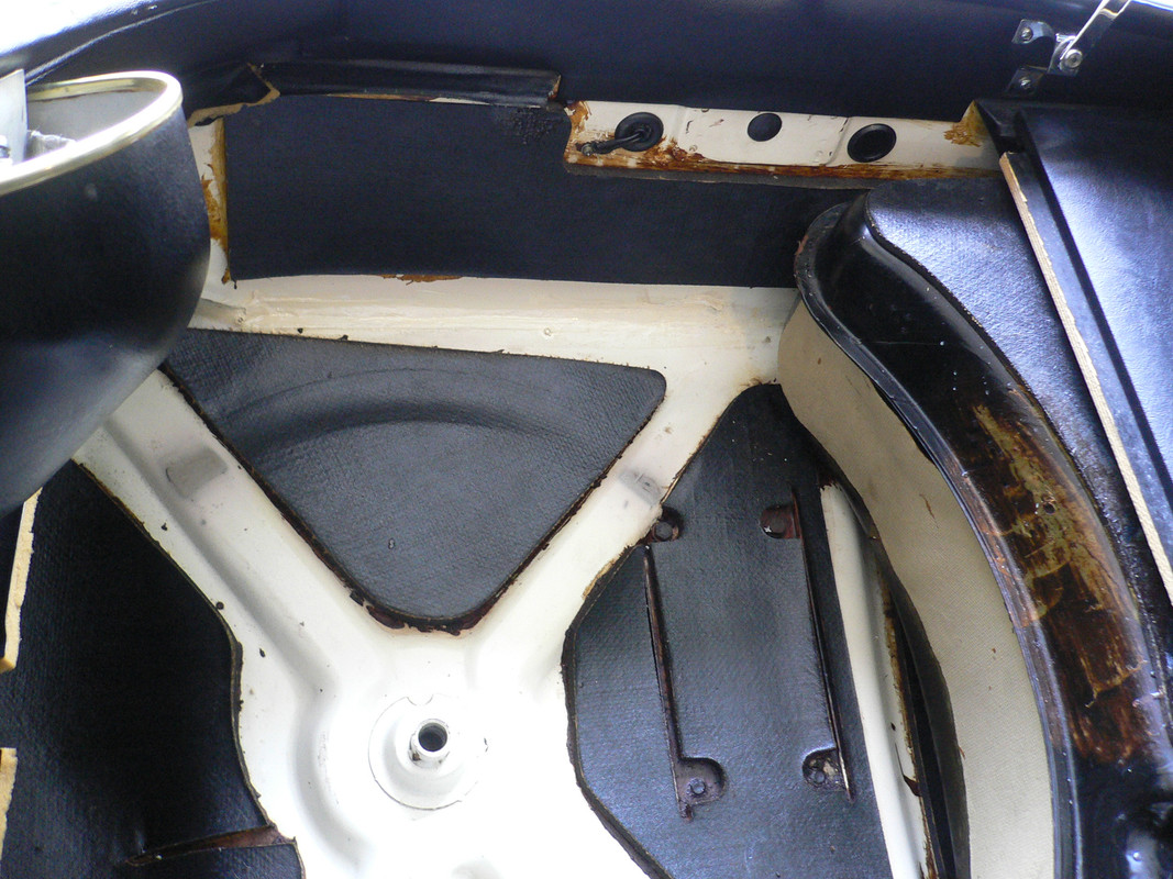

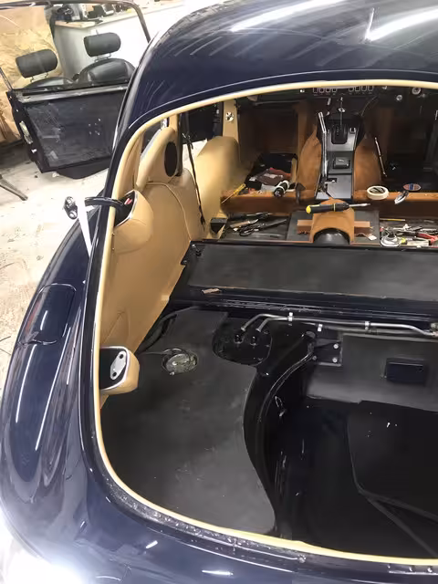

Hi Guys
Can anybody confirm whether the wiring that serves the rear end (ie) brake light/reversing/lights etc should be showing in the boot area (See photo)
I thought that this all disappeared in the void-aperture/behind that area. Also has anybody got a photo of where the trim finishes in the same area (see Photo)
As you can see its partially fitted but unsure where to finish under the boot boards.
Any help appreciated
Many thanks
Colin W

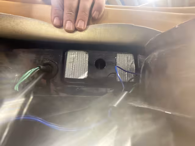

Looking at the photos there are the holes that have the wiring grommets which suggest that they should be there but it does seem illogical to have the wires in the open boot area which are open to getting pulled/broken when removing the spare wheel albeit they are under the boot boards. So if anybody can take a photo of their setup or can advise it would be appreciated

Your wireing should all be hidden behind the trim panel's ..Steve
#8 Re: S3 V12 2+2 1973 rear end wiring/trim
Hi Steve
Many thanks for responding and confirming that these wires should not be showing. I just found an earlier post showing the routing of the wires which looks like removing the rear lights and number plate and using a fish tape to pull them through the cavity.

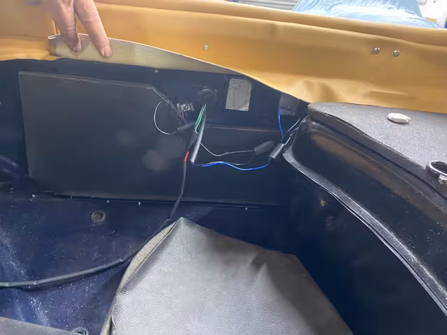

#9 Re: S3 V12 2+2 1973 rear end wiring/trim
Hi Joe
Thanks for the photo which is fantastic.
I have the two wires for the earth as shown in your photo and these are the only wires that should be showing.
The photo also helps with regard to the finishing of the vinyl
Really very much appreciated
Colin W
