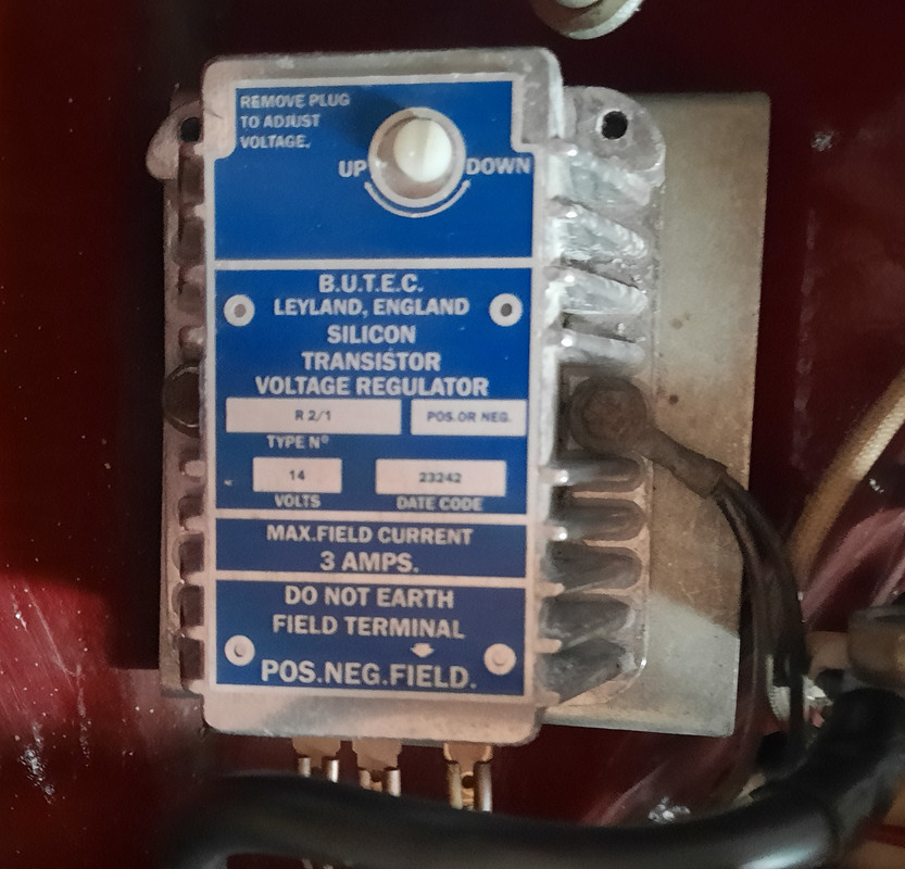

It is a BUTEC. I found an article which suggests running the car st 1000 rpm and then turning the adjustment screw clockwise to increase the voltage. I tried this with a digital AVO, but a 1/4 turn in small increments made no difference and I am not sure if it is a multi turn or dingle cturn pot, do I stopped.
Can anyone clarify this please?
EDIT image added

#7 Re: S3 battery goes flat
Post by Dachr » Mon Jul 21, 2025 12:55 pm
Just a thought.... should that white plastic screw be removed first, if so, how does it come out?

#8 Re: S3 battery goes flat
Post by MarekH » Mon Jul 21, 2025 4:19 pm
You probably need to know whether you have an original regulator or a repro. The originals are very simple and easy to repair and the web has plenty of info already published for you to achieve this. With a repro, you need to go back to he original vendor and get a circuit diagram for it. For all we know, what you have there may not be openable, settable or even alterable.

Post by Jack the lad » Mon Jul 21, 2025 7:47 pm
Hi David,
the plastic plug needs to be removed to expose the adjuster screw, it is approx, 20 mm inside the case and you need a small electricians screwdriver and torch. If you have no luck give the terminals a good clean up and try again. The earth wire on your photo looks a bit sus, check it is contacting the regs. case and it not insulated by the paint. if you cannot sort it you can send it to me for checking and refurb, I carry all the parts and a test rig, Also worth checking that the field connector is dead with your ignition key in the off position. More info. if needed just ask. cheers John.

Post by Dachr » Tue Jul 22, 2025 2:13 am
Thanks John, how is the white plug removed?
EDIT. After more research it looks to be a replica ftom Martin Robey. I will remove it and check the earth, etc.

#11 Re: S3 battery goes flat
Post by Jack the lad » Tue Jul 22, 2025 5:56 am
Morning David, the plug looks to be a plastic or nylon screw, if it will not screw out then a hot screwdriver pushed into it should provide enough for its removal. I don't know about the origin of the reg. but it will be an easy and cheap repair I'm sure, nothing to get too excited about. John.

Post by Dachr » Tue Jul 22, 2025 11:22 am
As an update, I spoke to the sales team at Martin Robey. They tell me the unit is not adjustable and my 12,8 volts "Seems about right"
I will still remove it, and check the connections as I am not convinced.
