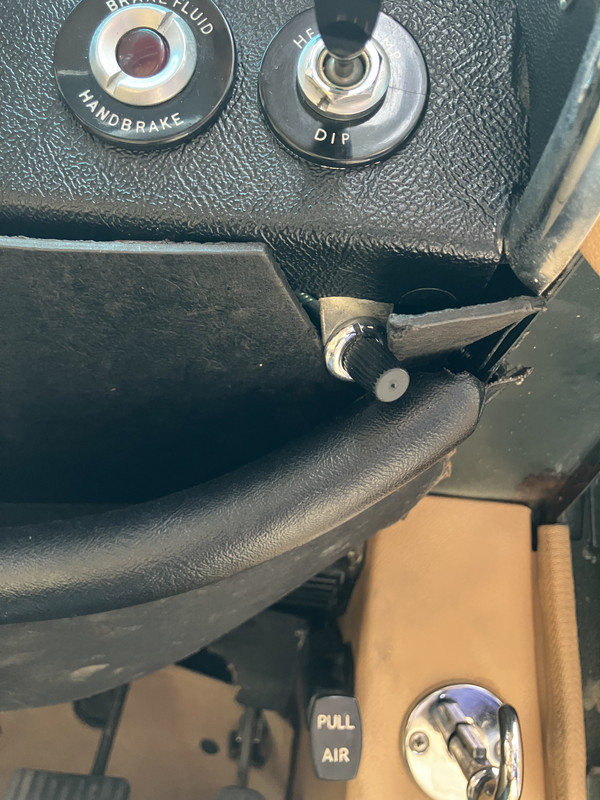

#8 Re: Instrument Light Brightness Switch
Thanks for the replies all.
It’s interesting that the U.S cars have a secondary dimmer rheostat knob in the footwell.
I have a mystery switch under the dash on the right-hand side of my RHD New Zealand market car, see photo.
I thought it might be either a dimmer switch or trip reset for the speedometer. Does anyone know what it might be?
S3 2+2 BRG
#9 Re: Instrument Light Brightness Switch
Pretty sure it's the trip reset. Only turn it anticlockwise!
