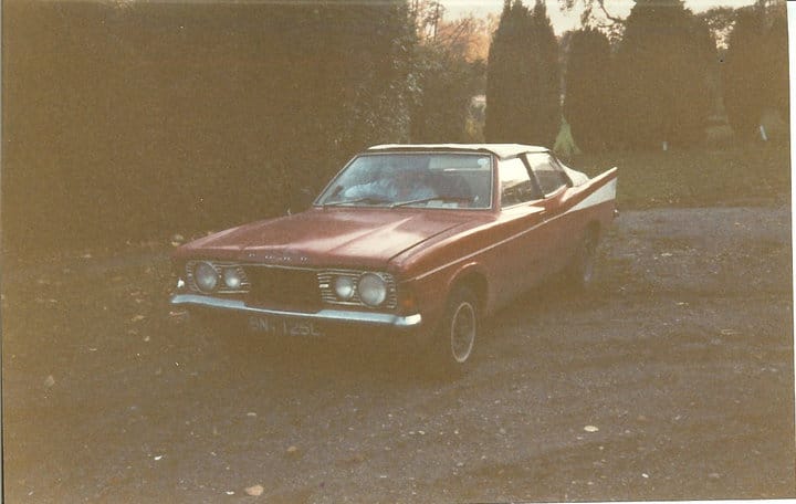

I used to have a car like that Marek, here it is.
Welding the doors up was a cheap way of making a convertible for an 18 year old!
Having sills that were 3 feet thick meant it didn't flex much, that's for sure.
Getting ladies in and out was interesting.
I insured it as a car with a large sunroof I remember.
The roof was home made. The car lived with me in London for 3 years!
Total budget for the conversion was about £50 in 1987.
