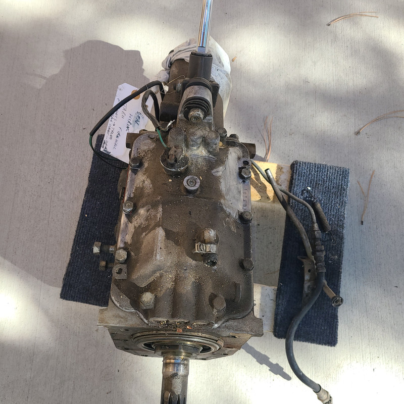

You asked: "Newbie question-can you see the gb number easily?"
Here is my origoinal tranny fresh from the tunnel. Note the clean area on the right side of the tranny in the photo:

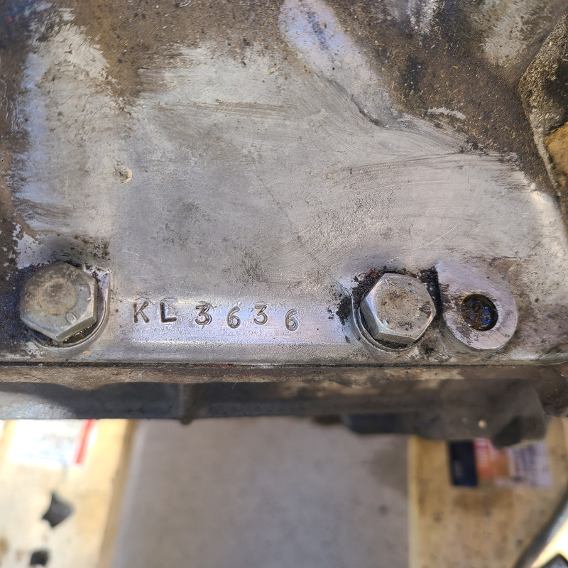

A close up photo from a different orientation
That stamping is on the cover of the tranny.
Getting to it will likely involve removing the tunnel cover or a lucky stab with a mirror on a hinged stick.

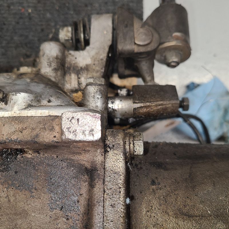

It is also stamped on the body of the tranny case:

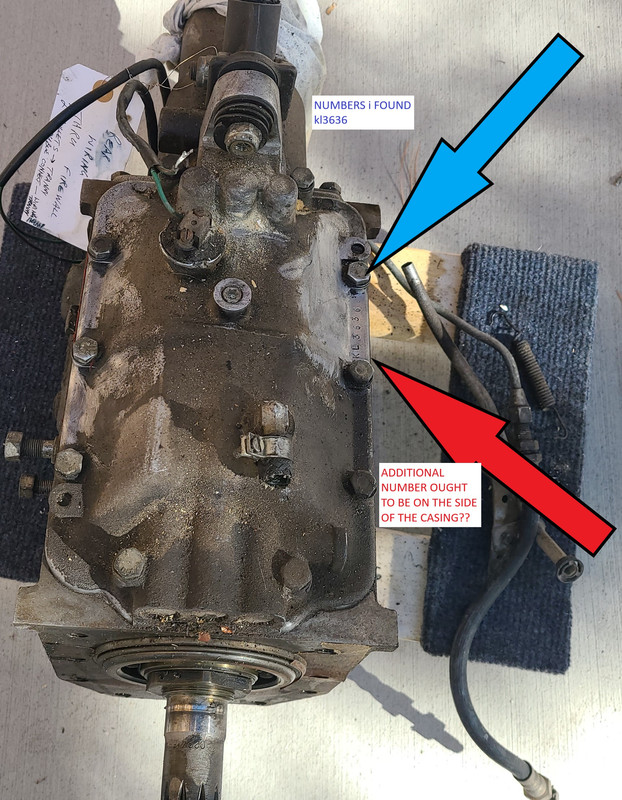

Overall orientation to the two locations of the number.
The blue arrow is pointing to the proper side/edge of the case, but the actual location is closer to the shifter.
Both location will likely need cleaning or oil/grease/crud to get to legible readings.
