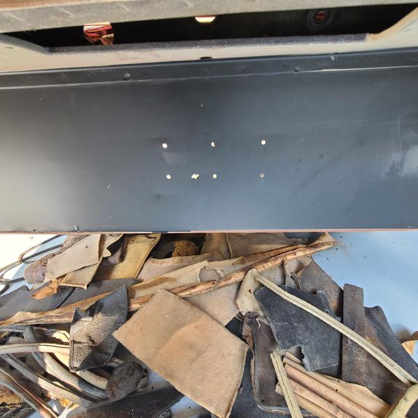

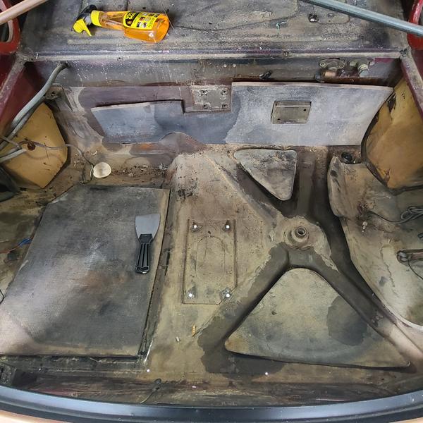

I realize you have a 2+2 and mine is an 72 OTS, but these photos from the rear, inside of my boot may give you some hints to research.
Bottom of the boot floor under the spare
I don't know the function of these 4x holes but there they are.
They are NOT covered when the boot is finished (at least in an OTS)

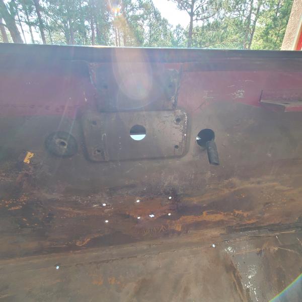

Here is a view from inside the boot looking directly rearward . . .
and the same view from outside the car (note the direct path from the rear license plate lamp assembly mounting are and the boot
. . . which provides three possible sources to explore (from the top down):
X- the reverse lamp assembly leads to two possible leak points
o - the mounting points for the lid (or maybe the hatch) latching point
o - two opening for wiring harnesses that are/were sealed with a grommet
X - the six mounting points for the US-style rear license plate (may be = those used for a European plate) (ignore the small rust hole)
X - two small holes along the body seam - I have no idea what their function/purpose is/was unless those are rivet holes to attach the rear plinth

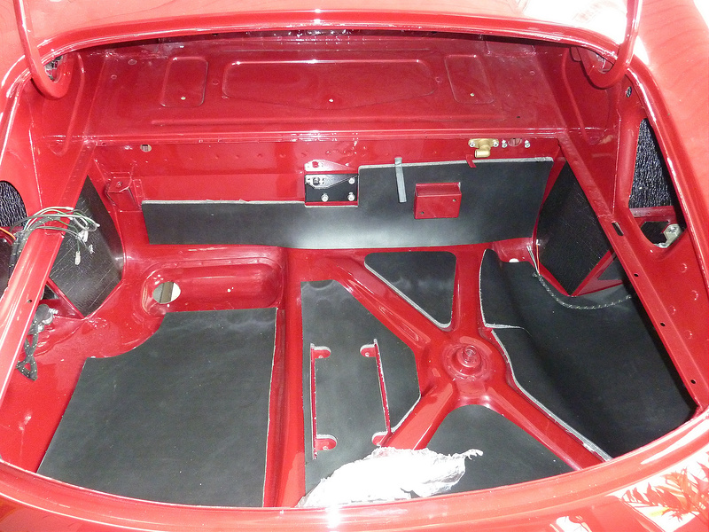

The rear 2 of the 4 holes in the boot floor are for the S3 rear exhaust mount. There's a stiffened plate spot welded above them. My floor had rusted betweenthese 2 pieces. I welded a new piece in and made it extendinto the stiffen to make the exhaustbolt fit better.
The small holes along the bottom of the vertical rear panel are for the pop rivets holding the stainless rear trim panel. There are another 2 below each rear light on the S3.
The void above the number plate light is part of the boot space. It's open at each end into the boot.
Other openings include:
Fuel tank vent pipe
Fuel filler area drain hose
2 holes in the fuel tank sump area, one for the fuel tank sump, the other takes a grommet for drainage. The fuel tank sump is sealed by a sponge ring.
2 grommets in the floor just forward of the rear panel
There's a few holes in the rear panel for number plate screws. I replaced the complete rear panel with 3mm steel instead of the normal 1mm as that's where the towbar mounts.
There's also some small holes foe the reverse lights and wires.
